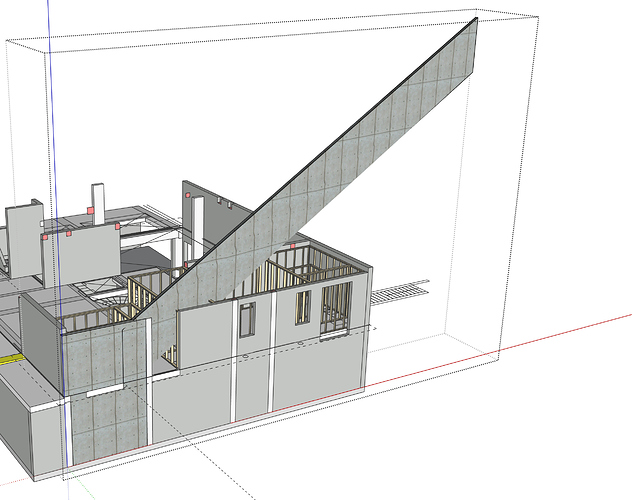

I am finding that when using push / pull or scale tools, too often the part being manipulated is transformed in unexpected ways. Very unexpected.
Here’s a screen shot of the result of a push / pull operation.

But, as is often the case, it isn’t possible to tell from a screenshot whether this is a bug, an issue with the specific model, an issue with an extension, or operator error. Can you share a model where you encounter the problem so we can see both whether we can reproduce the problem and whether there is a modeling problem?

Thanks for the video. I haven’t been able to get pushpull to do anything strange yet on the model. Scaling the steel columns also seems to work ok.
In your initial image, you showed a wall going off at a diagonal. Was that produced by pushpull or scale?
For pushpull it should be impossible to extrude in any direction except perpendicular to the selected face. That’s inherent to how it works. Going in any other direction would be a serious bug that I’ve never encountered or heard of before.
For scale there are some traps you can fall into. For example, accidentally grabbing a different handle than you wanted will scale in a different way than you wanted. Getting the right handle can be awkward if all the handles aren’t visible or if they are close together. Likewise, forgetting or mistyping the units when you want a specific length will get you a scale factor rather than a new length.
I have seen examples of an extrusion going haywire when it involved one of the extensions that cuts a hole through multiple wall layers. There is yet the possibility some extension is misfiring or clashing with another…

The diagonal off shoot was from a push pull operation. As best I can remember, it only popped up in 2020. I held off on 2020 for the longest time.
