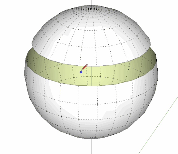

What does it mean to "manually close the mesh?"
What does it mean to Manually Close the Mesh? I didn’t open one.
Same question. It come up in the Solid Inspector extension in reference to “Surface Borders.”
Typically it involves drawing lines between vertices to create faces.

How do you close the mesh on a circle? It has no endpoints.
In SketchUp circles have endpoints. You can trace an edge segment with the Line tool.

Sounds like you don’t understand how geometry in sketchup works.
Everything is made of straight edges and faces.
