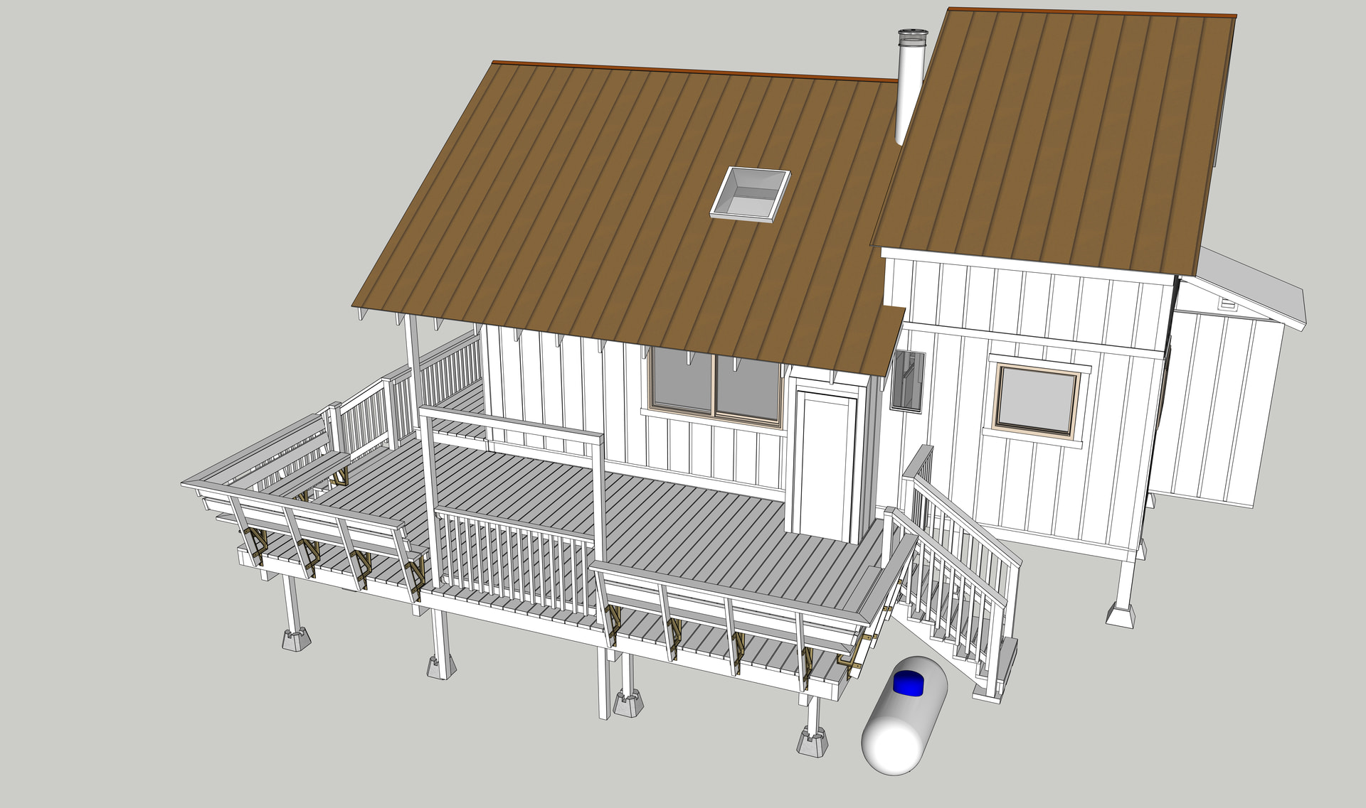

I switched over to a new computer which is Windows 11. The lines in attached model appear wavy. On my old Windows 10 computer, they appear fine. Any suggestions?

What youa re seeing is a moire pattern caused by the the crossing edges. I see it a little bit, too.
moire
The edges aren’t really wavy. If you do a large image export you can see that the wavyness isn’t present.

OK, so that’s current. Integrated GPUs aren’t real great for 3D modeling display.
Sketchup is just hobby stuff for me. The computer is more for other applications. I was having issues with the Windows 10 computer slowing down and acting up. Also, I’m in the process of updating the graphic driver from Intel.
