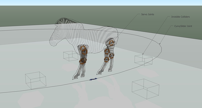

Thruster code for zebra body:
[(key('w') - key('s')) * 200, (key('d') - key('a')) * 200, (key('right') - key('left')) * 1000]

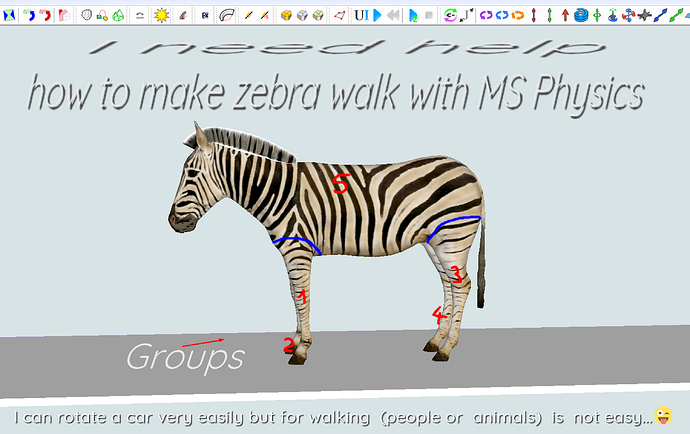

Make the zebra legs and invisible colliders frictionless. The invisible colliders are nested groups that go in the zebra body group.
29%20PM
Servo joint controller
(key('up') - key('down')) * -30
Tap ‘W’ a few times to move forwards, then repeatedly tap ‘up’ & ‘down’ to move legs.
