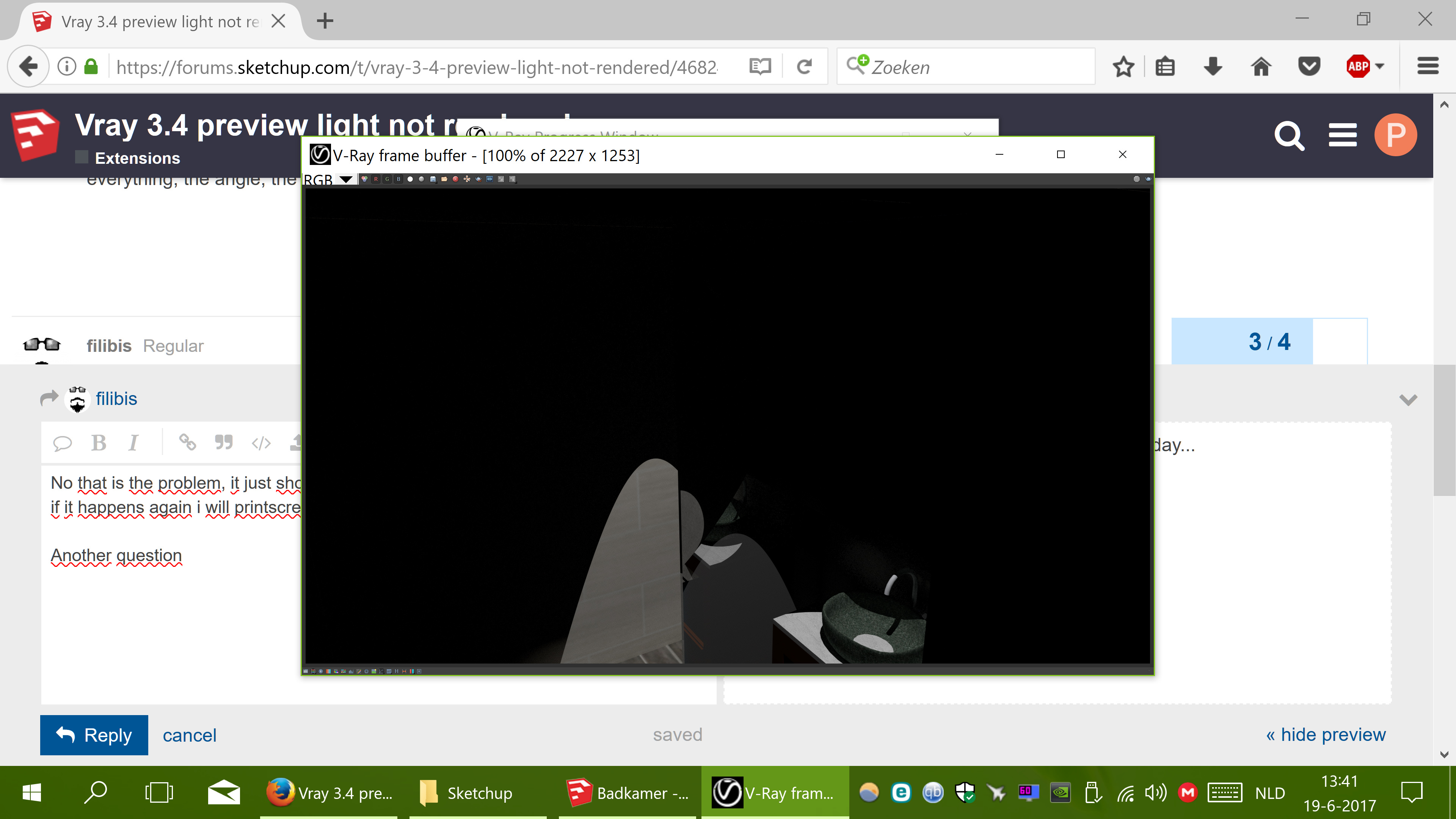

Hey, i saw it in Vray the other day , it surprised me too.
Also the program is very buggy it seems, somethings not rendering the scene that i wanted to render… and the small buttons because i have a 4k display…
Anyway, interactive render is a hassle because it has to render the image… and with that preview i saw everything, the angle, the light intensity, the light itself
Where? Can you share it?
Also try asking in official Vray forum as well. You’ll probably get a proper and up to date info.
No that is the problem, it just showed up the other day…
if it happens again i will printscreen it…

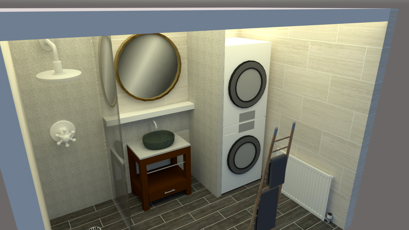

  2. how do people get those nice warm lighting? Cause if i set a spotlight in the bathroom, this is the result i am getting…
This is the result i am getting with plane light all over the ceiling
How do people getting this effect? Dont get it… the reflection ect…
You should ask your questions on the Vray forum. You will get many more Vray users seeing your questions.
In order to get this sort of ‘good’ renders, you need to ensure 3 things (which are equally important):
1- Your geometry must be refined and detailed enough for your needs. I see in your renders some ‘choppy’ objects such as mirror or washing machines has no buttons or wafer thin heater core or invisible liquid soap? :upside_down: Consider placing objects that makes the place alive.
2- Material must be elaborated. New Vray has quite a lot of premade materials that you can use or check other resources, investigate their material settings and tweak/test according to your needs. Slight bump or displacement on floor & walls might be useful.
3- Lighting and render settings might look harder than rest but actually easier. Consider creating lighting fixtures with regards to your scene. Investigate the ‘good example’ you shared for this. Read this manual for render settings and understand their functions.
I hope these help for a start.
