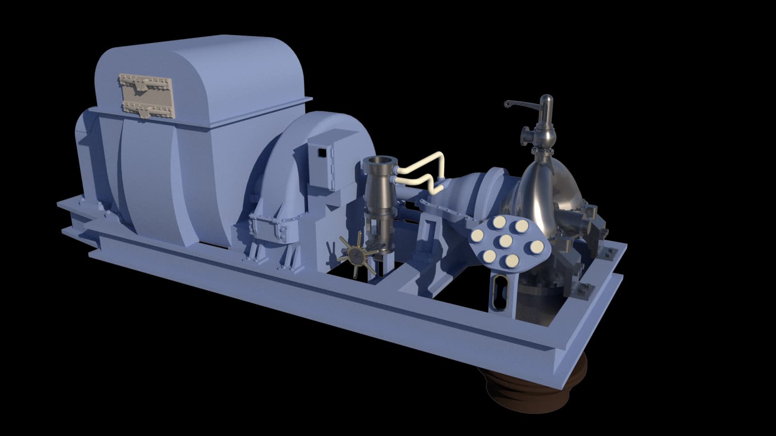

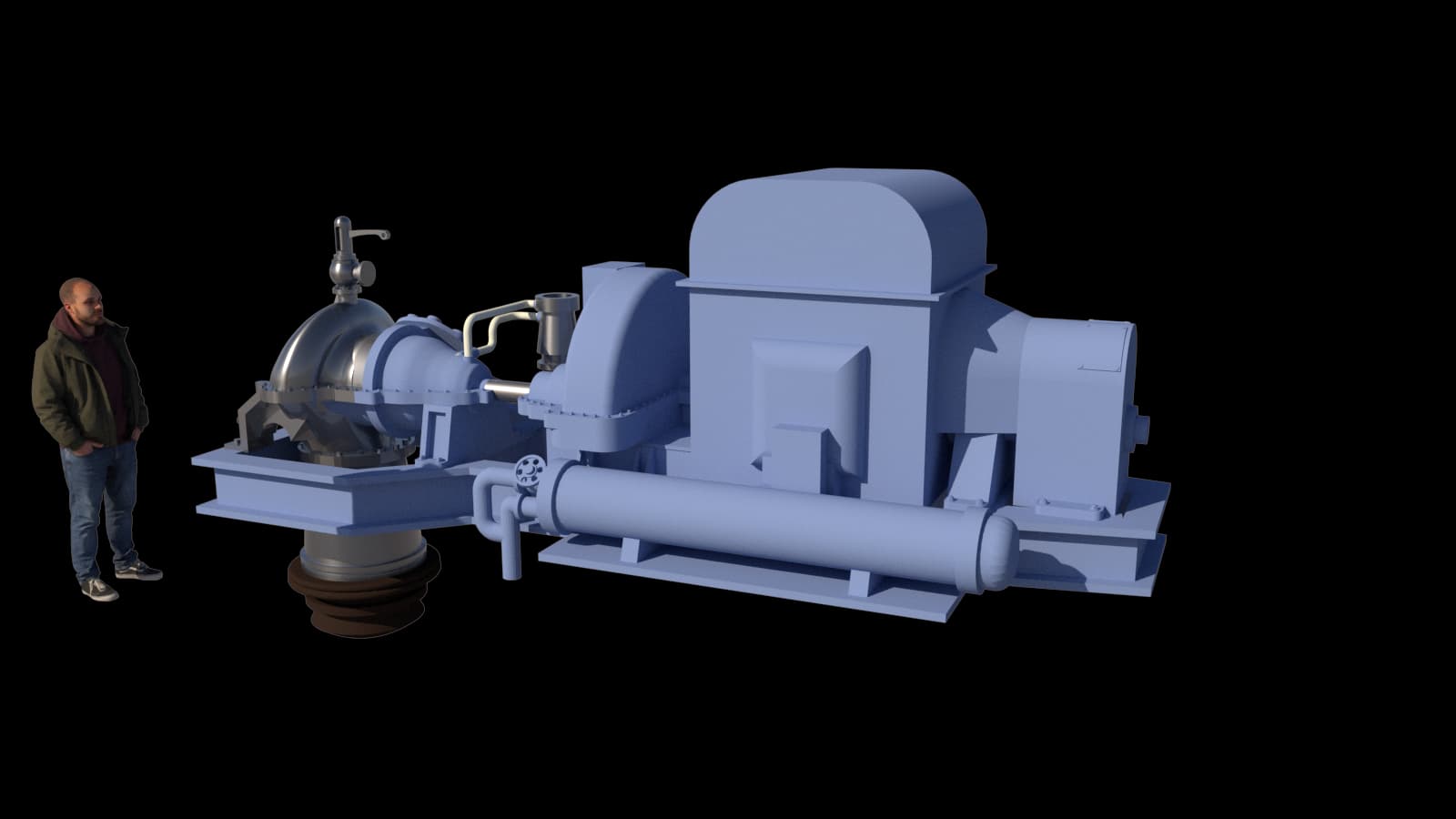

Today I finalized the upper part of the steam Turbo-generators (TG). There are two of these identical 1,2050 KVA units in each engine room. The battleship is an energy hog with every system being electrical or electro-hydraulic in nature. They both sit on their own cylindrical condensers that tap their cooling water from the main condensate system for main propulsion.
I’m happy with the results, but it was touch and go for a bit. After I finished it up I plopped it over the master drawing and WHOOPS! It was much smaller than it should be. It wasn’t just a scaling-up problem. I had to rebuild it. I’ve said it before, "Fixing an SU object is often harder than redrawing from scratch. Case in point… I started trying to reshape the frame. I ended up erasing the whole thing and building it new with the right proportions. I had to do this a couple more times.
I’ve tested the object in the slicer and it will print as a single part. With the new slicer it automatically puts supports in hidden areas that greatly increases success when printing complex objects like this one.
