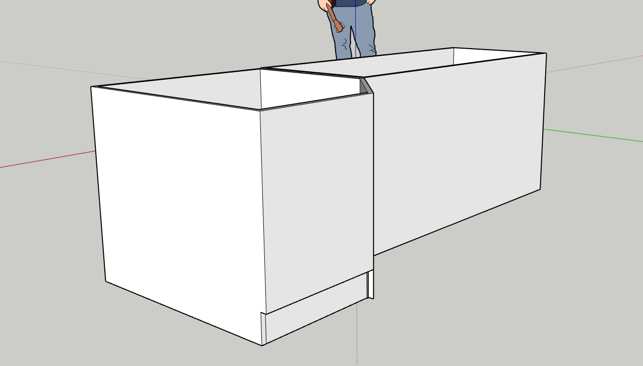

When i try to add a toe kick on the base angle it says that there is a max offset. im new to this so im not sure why it wont let me do it, any help would be greatly appreaciated
Looks like you are using Push/Pull and running into the edge of the angled face. Do you want the toe kick to follow the entire front of the cabinet? I so, use Follow Me. It would help if you share the .skp file.
fm
Not sure how to share the file, i think this is also causing an issue
The missing bottom will result in a strange thing but won’t keep Follow Me from creating the toe kick space.
fm
Download the .skp file to your computer and then drag the .skp file into a reply here.
