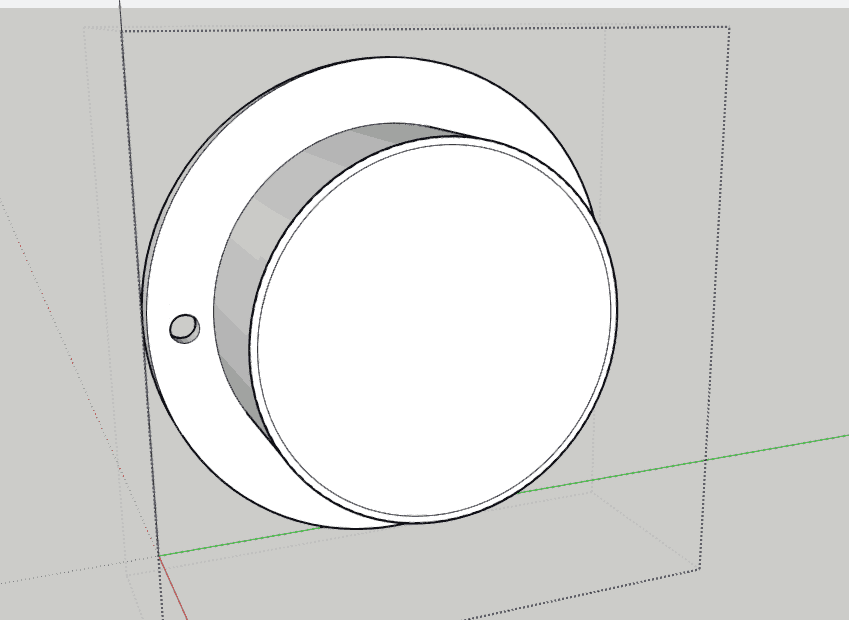

Getting there. but i can’t seem to add thickness to this end cap to put on the end of the tube. i want it a m think, will then scale it down to its real size for printing. also need to add some lamp holes and a cable hole.

The point of working in metres is you don’t have to scale down when finished. .stl are unitless, so if you export as Model Units when opened in your slicer it should be seen as mm.
i suspected it was just playing to our imagination of what ausies are really like lol im at the stage now of about to print a prototype. is it possiblt to easily add a hole for the cable in the circle? it doesn seems so unless i go back in time and redo some stuff…
elementcover (2).skp (206.0 KB)
Yes, it will no doubt be quite simple, but .you’ll have to wait for someone who can download your model.
hole
edit - offset - push/pull
Your gif shows what looks like a double circle on the outer edge, perhaps circles off axis.
there actually are 3 circles :scream:
one is easily deletable as it’s exceeding the cylinder diameter but the two others created voids
thnaks paul. now i just need to add a cable hole at the btm.
here in the btm part of the ring body.
ouch, thats probably not a good thing,… its printing now, will see what come sout lol
here is a fixed version :
elementcover solid.skp (200.2 KB)
thanks mate, will work on this version

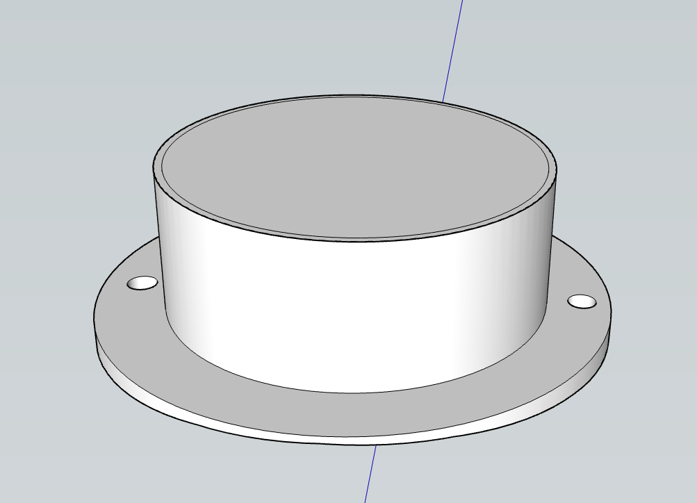

Good day,
Perhaps this is what you have in mind.
The main tube is 45cm Dia. The hole sizes and cover sleeve are for example.
cable cover.skp (417.1 KB)
