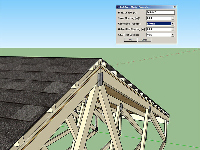

When combining different roofs on complex structures I often find myself having to delete the outlookers, overhang and gable end truss on one end of the roof assembly. Then today I had a request from a user to enable the ability to limit the gable geometry to only one end. Based on this I will try to set up another option for the gable end truss option which allows for only the creation of one side with the gable end geometry. This means I will have to rework some of the advanced options to make sure it is compatible but I think I can make it happen fairly quickly.
In response to a recent request about gable ends of the roof assembly I have created an additional option in the “Gable End Trusses” option when creating common trusses. The new “Front” option only creates the gable end truss and gable end geometry on one side of the truss assembly and leaves the other side open as shown below:
This should come in handy when creating roof assemblies that butt up against walls and other complex configurations (ie. T-shaped buildings requiring Valley Sets etc…)
