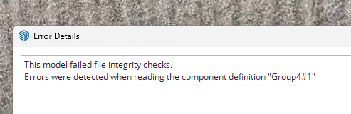

What version of SketchUp are you currently using? There’s a bad group in the model.
Update to SketchUp 2025 and you’ll be able to open it.

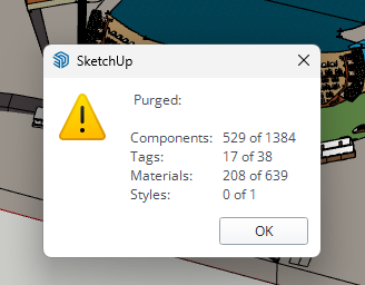

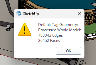

BTW, I would suggest once you have the model opened that you clean it up. Fix incorrect tag usuage.
Purge unused content. There’s no need to be hoarding all that stuff.

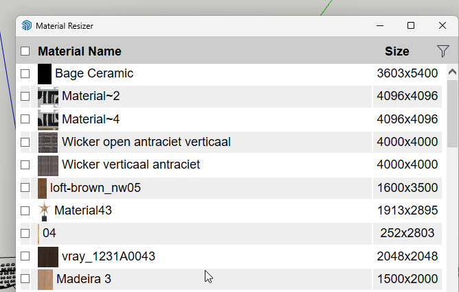

And reduce the excessively large textures. They are downsampled by SketchUp anyway so their huge size just bloats your file without any benefit.
Just that cleanup will reduce the file size by about 45%. More could be done to reduce some of the overly detailed entourage components, too.
