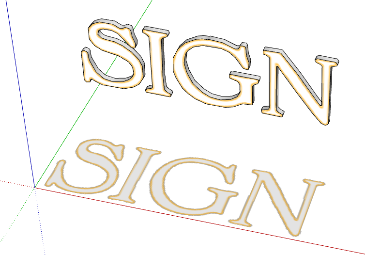

You could use Fredo6’s Pic2Shape or TIG’s Image Trimmer, both from Sketchucation to make actual geometry cut to the shape of the text so it can be extruded. Then make that a component which you can save in a component collection for future use if you need.
A quickie example using Pic2Shape. Original image on the ground plane.

Dave, Fredo6 Pic2Shape did the trick. I don’t think it can allow me to Push/Pull the image once the plugin has finished, I could only get the shape to make a copy of itself when trying to extrude. Still, I managed to get the textures from the image so just a big thanks for jumping in to help.
