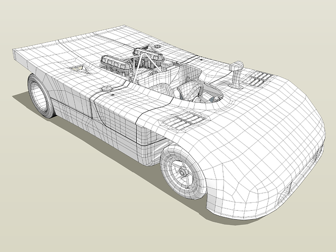

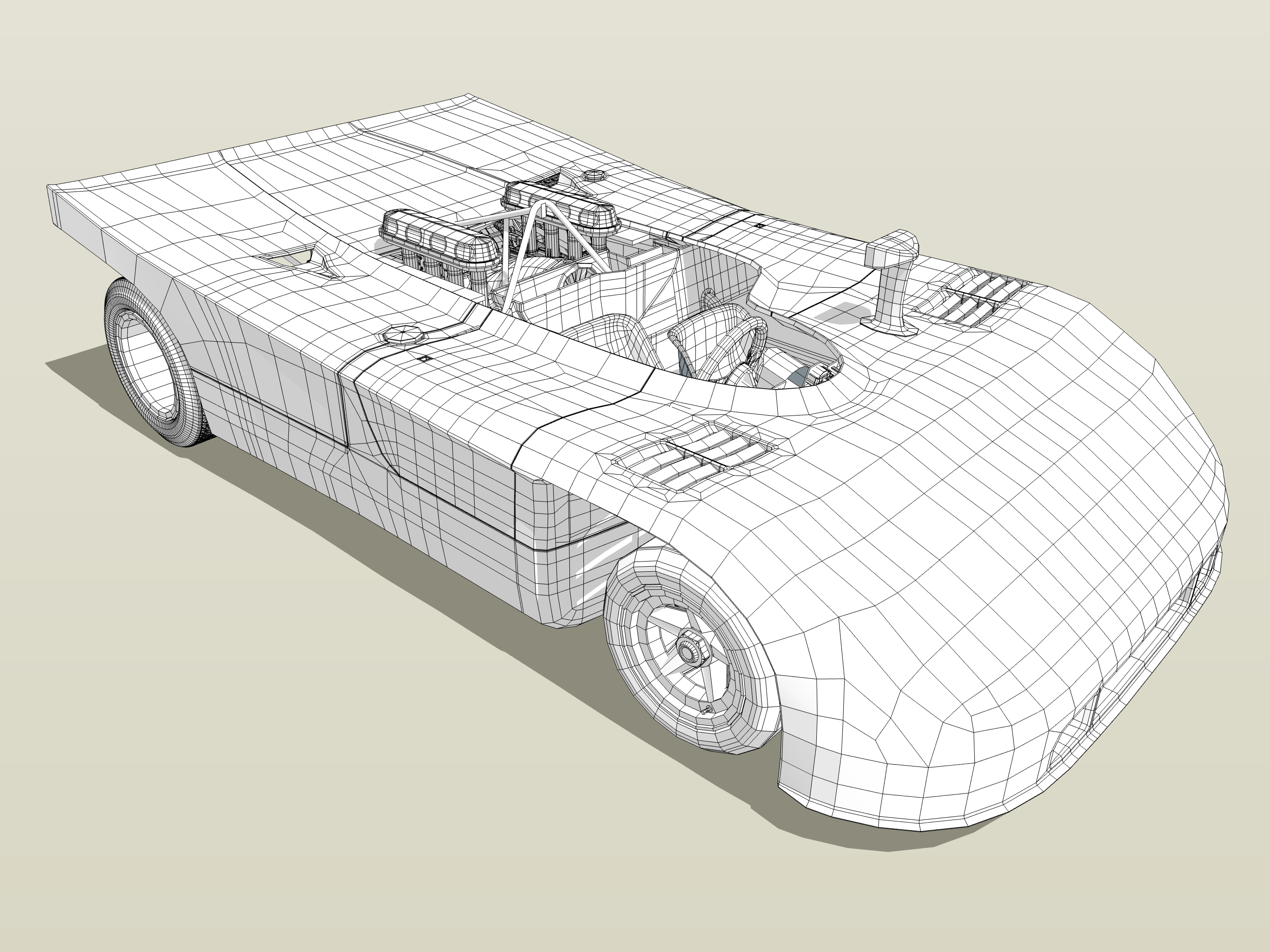

Still straightforward and pur sketchup…

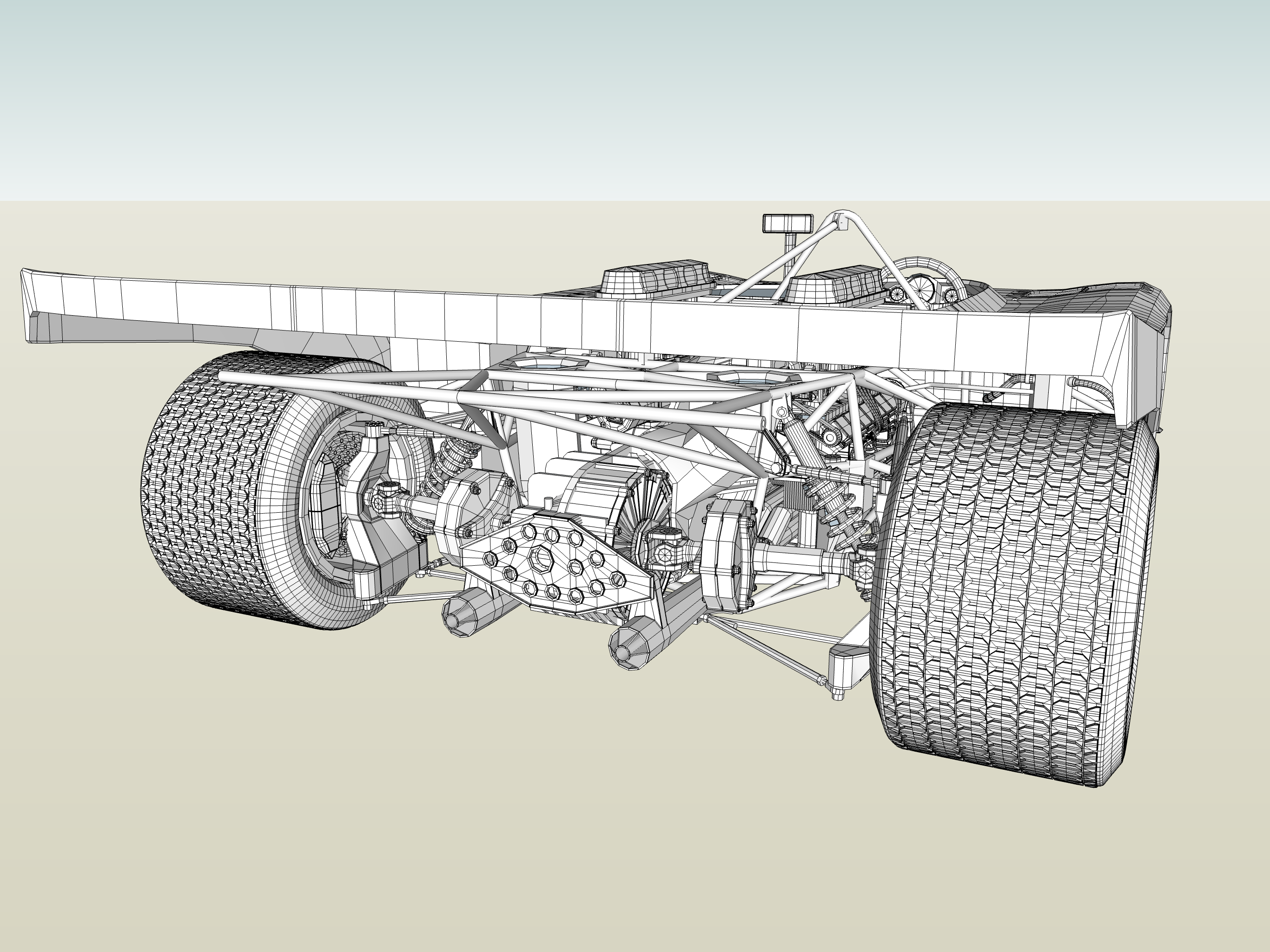

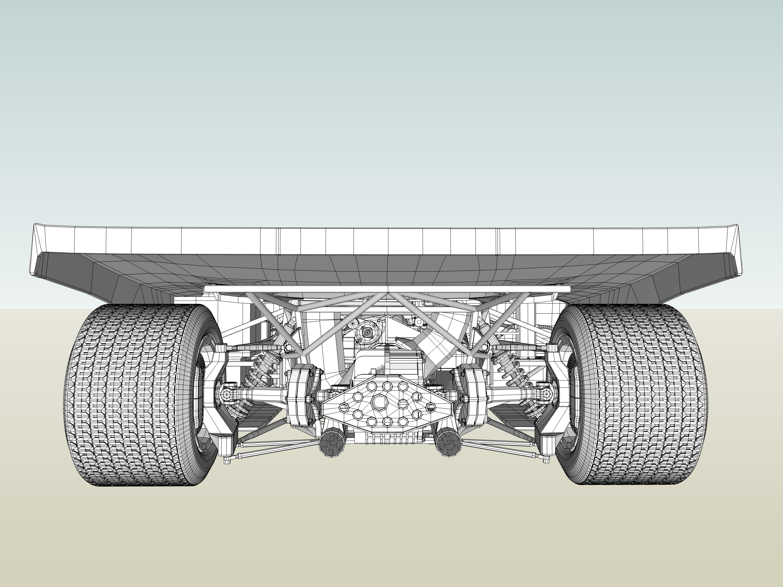

Rear tyre thread done, made with components.

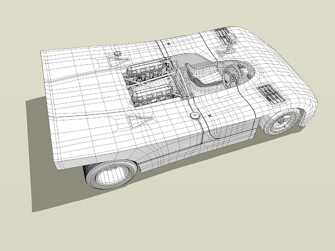

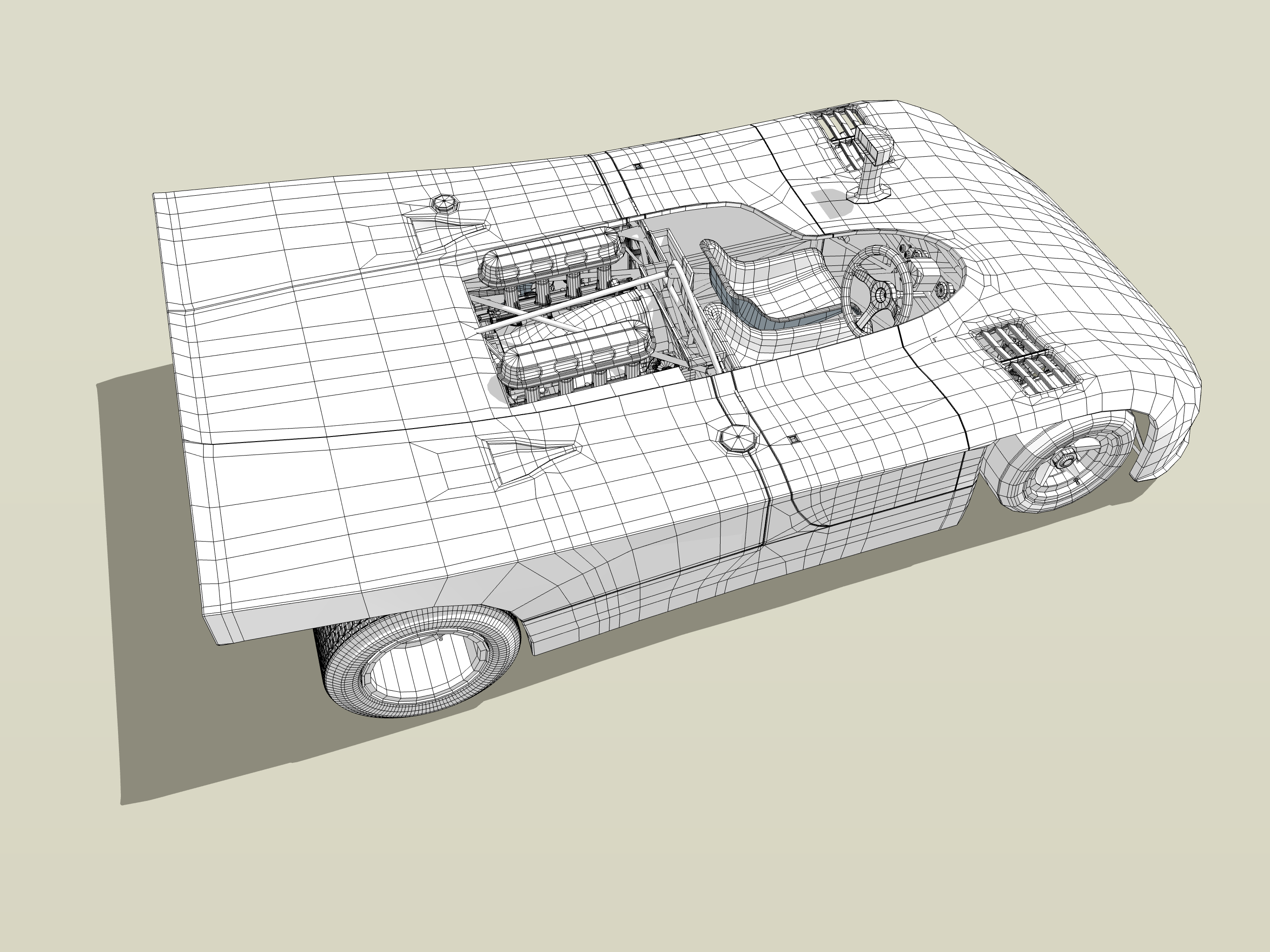

Body work adjusted and thickness for 3d printing added.
Tyre is made with 120 segments, each segment is a component and has a component for the tyre shape (2x), a component for the thread (6x) and a component for the small thread on the outside (2x). I need only to subd the components of one segement and get the whole tyre subd in faster time instead to subd the complete tyre mesh.
