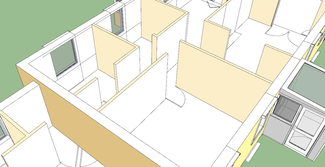

  2. Materials - Currently modelling a bungalow, the internal walls should all be one colour. I add a beige colour but SUP shows some of the wall surfaces as white even though colour picker sees them as beige. When I export the model to Lumion, it sees the white as a different colour too. See the SUP snap shot here.
Can anyone please advise? Thanks.
Are you using Use sun for shading (Shadow properties)?
If so then either untick that or adjust the Light and Dark values
Have you checked your face orientation?
Hi @paul.mcalenan. Thanks, that works fine.
