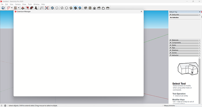

I have seen that other users have had this problem in the past but none of the solutions have worked for me. I recently updated my Windows 10 laptop with a new Windows 11 laptop. I installed SU with no issues and was in the process of installing my extensions, again, with no issue. This morning I tried to install another but after logging back into my Trimble account the Extension Manager window is blank.

I also noticed just now as I took a screenshot that the Extension menu heading is also missing as well.

UPDATE: I did figure out how to install an extension manually and have gotten a couple installed that way. And–of course–the Extensions menu title magically appeared.
Each time SU opens it prompts me to update 3 extensions but I am unable to do that because the Extension Manager window is still blank.
The problem might be that web-related services in SketchUp 2020 don’t work as they use an old browser that is no longer supported.
Another possibility, when you installed SketchUp, did you right-click on the downloaded file and choose “run as administrator”? If no, right-click on the downloaded file and choose the repair option.
Possibly. I do know that SU worked correctly, even the Extension Manager, over the past week. The 3D and Extension Warehouses have not been available in SU 2020 for quite some time.
I did run the installer as administrator, yes.

None of these have resolved the blank Extension Manager window . . . but I have managed to manually install most of the extensions that I use regularly. As mentioned Extension Manager functioned properly prior to yesterday morning but it had been a few days since I used it so it is hard to say when and why it actually stopped working. I find it interesting that previous posts mentioned OneDrive because I have had quite a battle reclaiming my files from OneDrive and eliminating it from my present system (it will probably rear its ugly head in a Windows update someday!) and this install of SU Pro 2020 was done after that.
