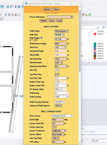

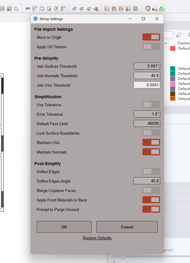

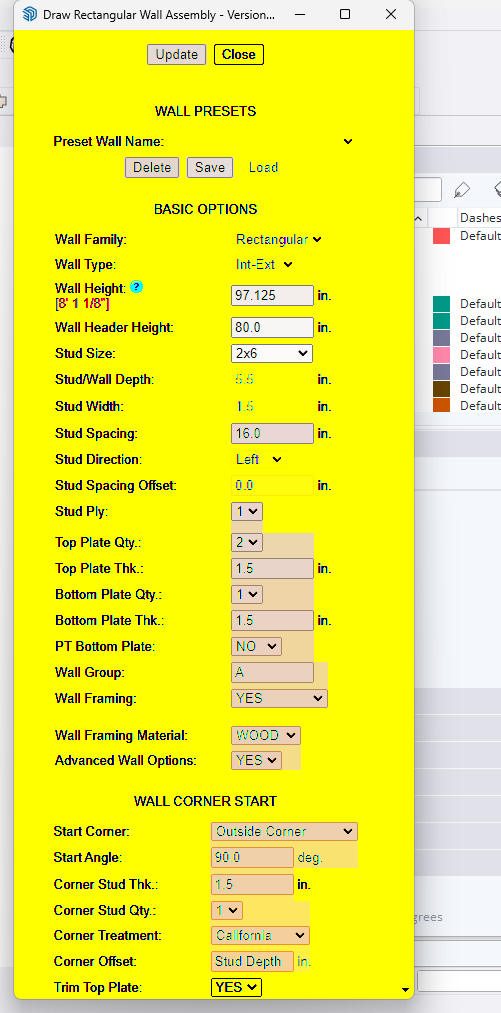

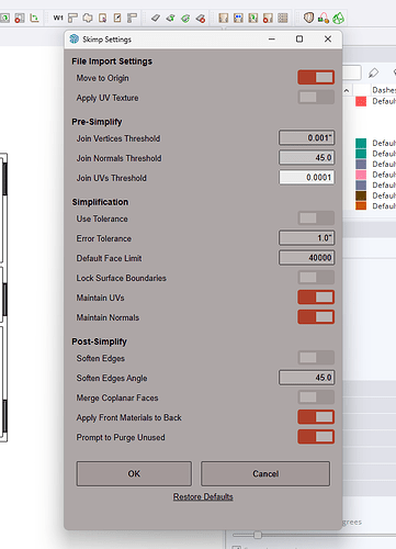

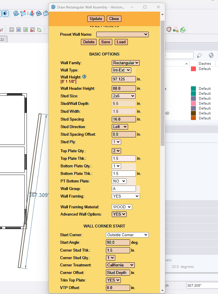

After updating to SU 2025 my extension windows are having display issues. I’ve checked and this is not a problem in SU 2024. Everything still works but it’s annoying.
Has anyone been experiencing the same thing and have a fix?

No need to try to be smart ass. I explained that I’m having display issues. The images are showing the discoloration of the pop up windows. Not sure how that’s not clear. If you’re not familiar with Medeek, that’s the first two images to create walls. The third image says what it’s for on the top of the window, it’s Skimp.

The main difference between SU24 and SU25 pertaining to UI::HtmlDialog windows, is the update from Chromium 112 to 128. This can bring with it changes in HTML and CSS rendering or support for new features, as well as more stringent parsing. (CEF is notorious, with me at least, for pooping out whilst parsing CSS stylesheets if it encounters a syntax error. This causes the remainder of the stylesheet to be ignored. This results in partially styled dialog content.)
