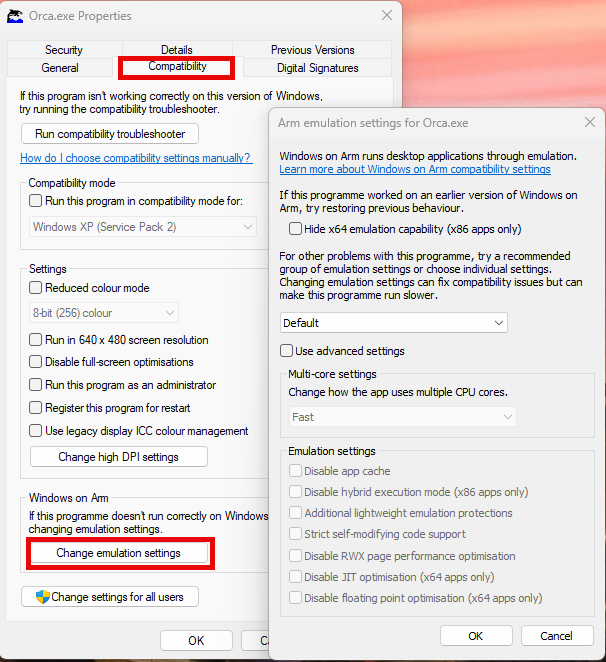

There are so some settings you can play around with in Windows
Also, you could try switching to the classic graphics engine - that is probably using less complicated stuff and windows might be better (or worse!) at dealing with it.
