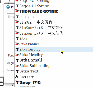

Aye, i have three Tahoma fonts listed …
… but sketchup does not recognize them all?
SUP22 i do see tahoma but with only regular or bold options:
SUP2025 i do see Tahoma font, but only regular option, not even bold?
sup25 tahoma font options issue
Luckely i do not use this font (often), so no issues here, i’m just curious about the possibilities.
(since i have a font library of 10K+ fonts :innocent:)
Look at the font options for regular text, not 3D Text.
Since installing the italics version a little while ago, I now have italics as an option in 3D Text, too.
