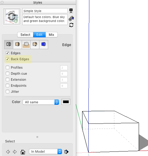

If they’re dashed lines, then maybe try unchecking back edges.
It could be an easy fix but it might not be, too. Can you share the file? Generally 2D CAD files don’t import with faces.

Hi, Back edges wasn’t checked. Think I’ve just got a lot more learning to do!
