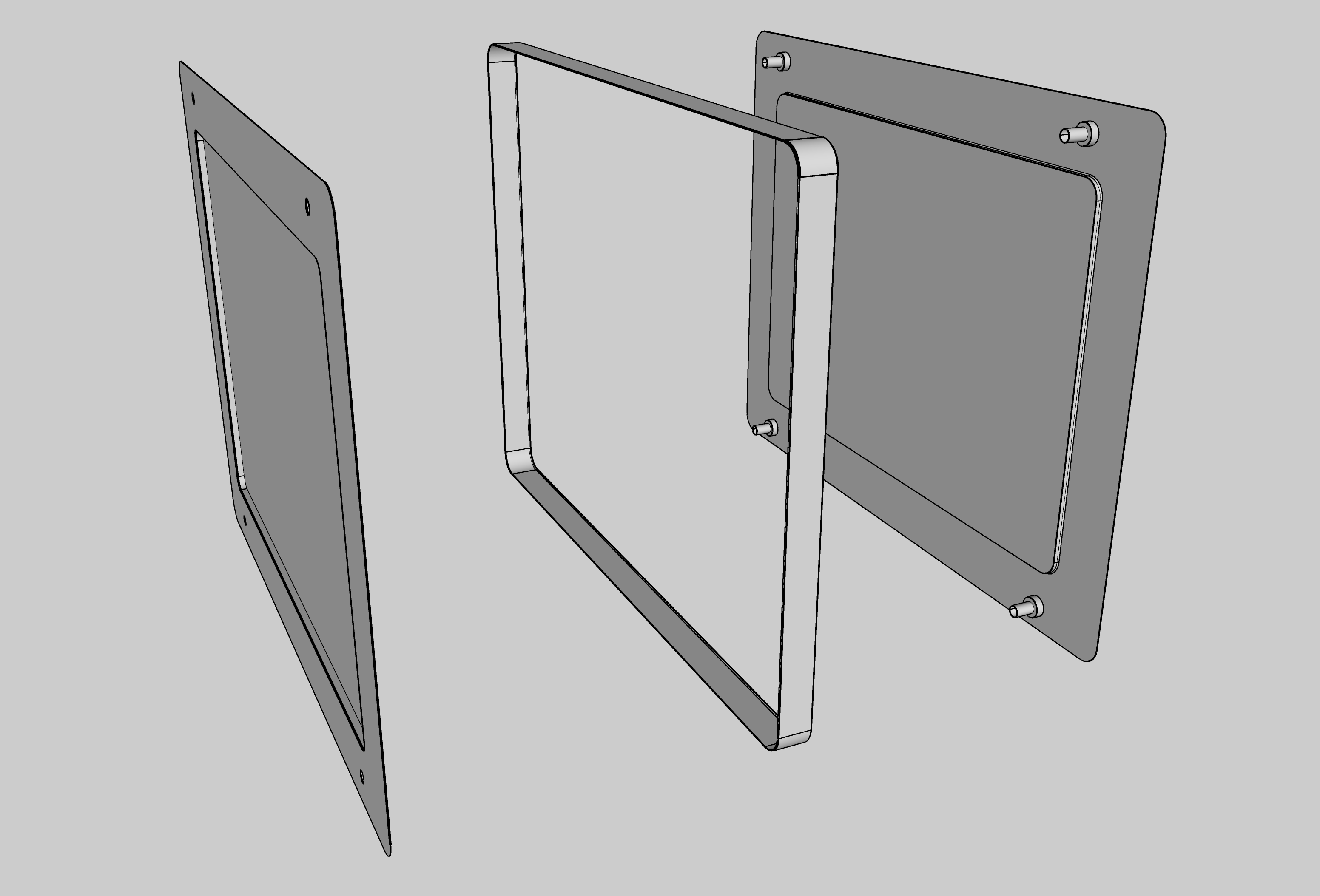

im new to all of this but is it possible that the original file consists of multiple parts because i had a look at it and it doesn’t really make sense ?
I pulled the model apart a bit. There are some internal structures but it does not look like the diagram you posted. Here it is with the front and back pulled apart. I see some tubes that sort of look like they are in the position to be fastener tubes, but they do not open on the back and are not connected to the rest of the geometry. Furthermore, all of the pieces I pulled apart are single faces, not possible to print by themselves as they have no thickness. I don’t see a way to use this file as an iPad case.
Looks like it should break down into two parts, one screws on the wall with the depression for the ipad, the other is the cover for the screws and to trap the ipad with an open front.
