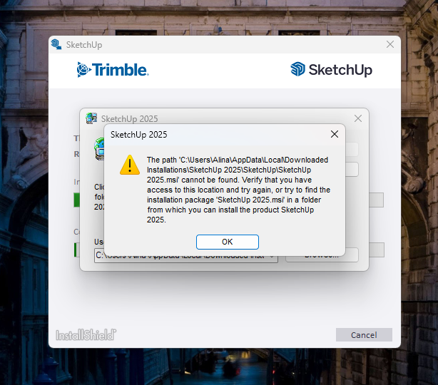

Tried to install 2025 10 times now since 2024 said I have to update to continue my subscription but it does not work. It gives me three options at the start: language choice, repair and delete app. None of which work. I was meant to start work 3h ago but it is impossible to even open the application. I even uninstalled all previous versions got 2025 again restarted my pc and still getting this

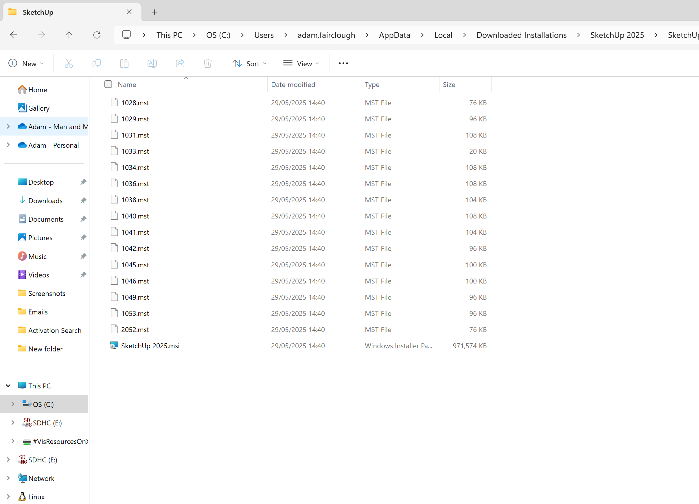

You could even try keeping the folder open paste this into the folder bar
C:\Users\alina\AppData\Local\Downloaded Installations\SketchUp 2025\SketchUp
and keep this folder visible as you run the installer it should have these in - if one is appearing then disappearing, then that means something is moving it.
