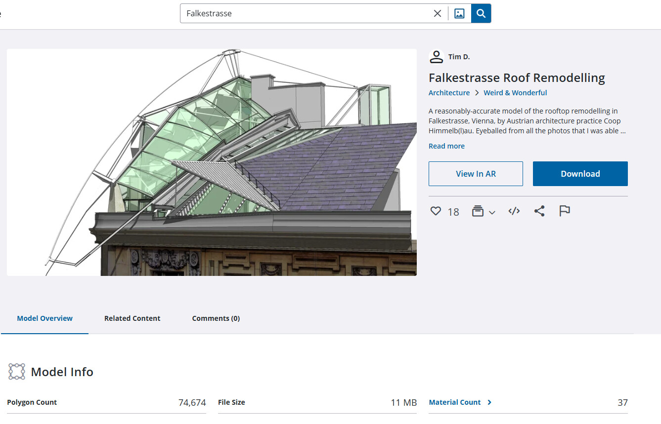

Dave – it’s the Falkestrasse model that’s on the 3D warehouse…
This one?
I can see why you might have a performance hit with that model. There isn’t a group or component anywhere in it. All the components such as the chairs around the table have been exploded to raw geometry.
I wonder why it’s 74Mb on your iPad. It’s only 11 Mb (10.9 Mb) in the 3D Warehouse.
