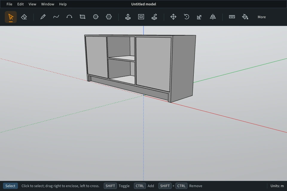

I’ve read that SU’s programming code may be holding it back from certain UI requested updates & may have something to do with SU-Layout being slow to use. I don’t know anything too deep about programming code per-se, so I asked GOOGLE-GEMINI-AI to research this & compare SU & IngeTrazo in this regard. See below for the findings. Can experienced users who know about this subject comment on these findings, given AI can sometimes paint a distorted picture…:thinking:

  • Underlying Architecture: Developed using modern Python and Qt / PySide6 frameworks, combining a high-performance geometric engine with a clean script-driven action API.
  • Code-Based Pros: Highly modular, lightweight, and agile. Its integrated design choice—building the sheet composer directly into the main application core—eliminates the laggy inter-app communication loop that plagues SketchUp and LayOut. This allows it to render scaled vector sheets smoothly.
  • Code-Based Cons: As a younger project built on a Python/Qt wrapper stack, it lacks the decades of deep, low-level performance tuning that legacy commercial C++ software has undergone for massive, hyper-complex enterprise models.

First of all, it is not certain that IngeTrazo renders drawings using vector graphics. This point needs verifying; perhaps the framework handles it. That represents a significant development task (I have been working on exactly that for months…).
Next, the slowness issues in Layout have been resolved; there was a major display bug related to Retina screen support I guess. That leaves the vector display. It is inherently slower, but there seems to be an optimization issue somewhere. Exporting vector AutoCAD files from SketchUp appears faster than rendering vector graphics within Layout.
The Google-Gemini hypothesis is interesting. I don’t know if it’s true, as I don’t have access to Trimble’s internal development details. Personally, I would have duplicated the vector rendering algorithms in each application rather than sharing them… If that is the case (it seem absurd), it could explain the slowness. In any event, the issue isn’t simply due to there being two separate applications. That said, integrating everything into IngeTrazo is a very elegant and compelling approach.

This is AI hogwash, don’t believe everything you read. Gemini is regurgitating a mashup of terms it harvested from reddit backroom rants. There is no apples to apples comparison here, and much of the the below simply does not make any sense.
At this stage, it’s too early to weigh pros and cons. IngeTrazo’s main advantage is being open-source, giving it the potential to become the ‘Blender of Architecture’—provided the project is well-managed and gets the community backing Blender once did. However, launching an open-source project today comes with unique challenges. Years ago, companies like Autodesk and Maxon didn’t expect a small foundation to disrupt the industry standard for 3D artists. Today, companies like Trimble are far more watchful and will likely throw up hurdles to slow down competing tools.
