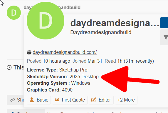

Please update your forum profile.
Thanks for the help! What do you mean by “update your forum profile”? Sorry, not sure what I need to do there.
Change the version number to 2026.
Thank you! I did!
