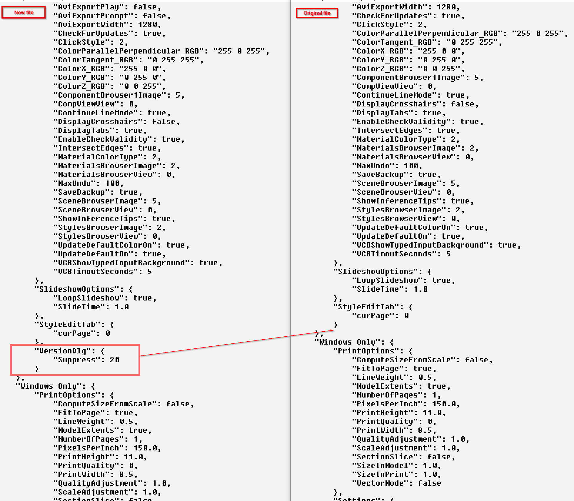

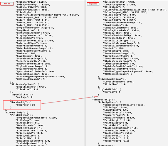

If it exists, it should be somewhere in the user AppData, PrivatePreferences.json (Roaming) or SharedPreferences.json (Local)
Much appreciated. I’ll give it a shot.
I have checked
In your Roaming folder
( c:\Users\your_user_name\AppData\Roaming\SketchUp\SketchUp 2020\SketchUp\ )
You have to put this to file SharedPreferences.json: I used windows Notepad to edit
"VersionDlg": {
    "Suppress": 20
Hint: make a backup of your original SharedPreferences.json… just in case

That did the trick! Thanks dezmo.
