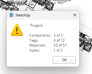

I agree with Colin. There are a huge number of text items in the model and they are taxing the graphics card.
I also notice a large part of your model is located at a huge distance from the origin.
After deleting most of the text and dimension entities the model is very quick to navigate through. Here is the file after removing those thousands of text entities.
not laggy 10-25.skp (421.7 KB)
