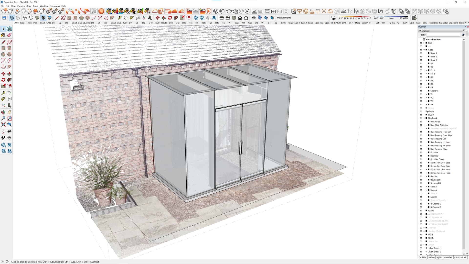

Interesting post. I suppose we all find the workflows for SketchUp which work best for us. I use Outliner for absolutely everything as you can see from the attached screenshot. In fact I do not use Tags at all. I find Outliner incredibly useful for creating the scenes I need to produce the detail drawings I require for our glass and metalwork structures, not to mention the various set-out, overview and elevation drawings. By grouping glass and metalwork together I can turn either on or off with a single click and control the visibility of nested groups. Personally, I cannot imagine using SketchUp without the Outliner. Cheers all.
Holy smokes! Dang that’s pretty cool Kevin! Some questions… So you make drawings from your sketchup stuff, as I do. So if you turn objects off via the outliner by toggling group or component visibility, you’re essentially hiding objects in scenes “hidden objects” via scenes panel and not using tags as a result of doing it that way. The only issue with that, is because a model like yours probably has hundreds if not thousands of objects at times, there would be no easy way of having a set way of toggling visibility of objects without first naming all new model objects for every project, and than setting up their visibilty in each scene every time for every project. If not using tags, this means that every project would have to have each scene reworked and every object would have to be named appropriately first as well. It’s essentially like recreating every single scene and toggling it’s settings for every project, there would be no easy way to make a template… Whereas with tags, you can create scenes that you setup once for every single project…?
Sorry - I’m not sure I got the gist of all that? I have never used tags so I can’t really comment on what they do. I simply rename the groups as I create them with fairly standard names and I group certain types of materials together for ease of changing the visibity. If I am detailing, say the glass, I will set a scene up with just 1 glass panel visible, then for the next scene which needs another panel visible I will hide the visible panel and unhide the adjacent panel I need to detail and save that as a new scene. Hope that helps.
