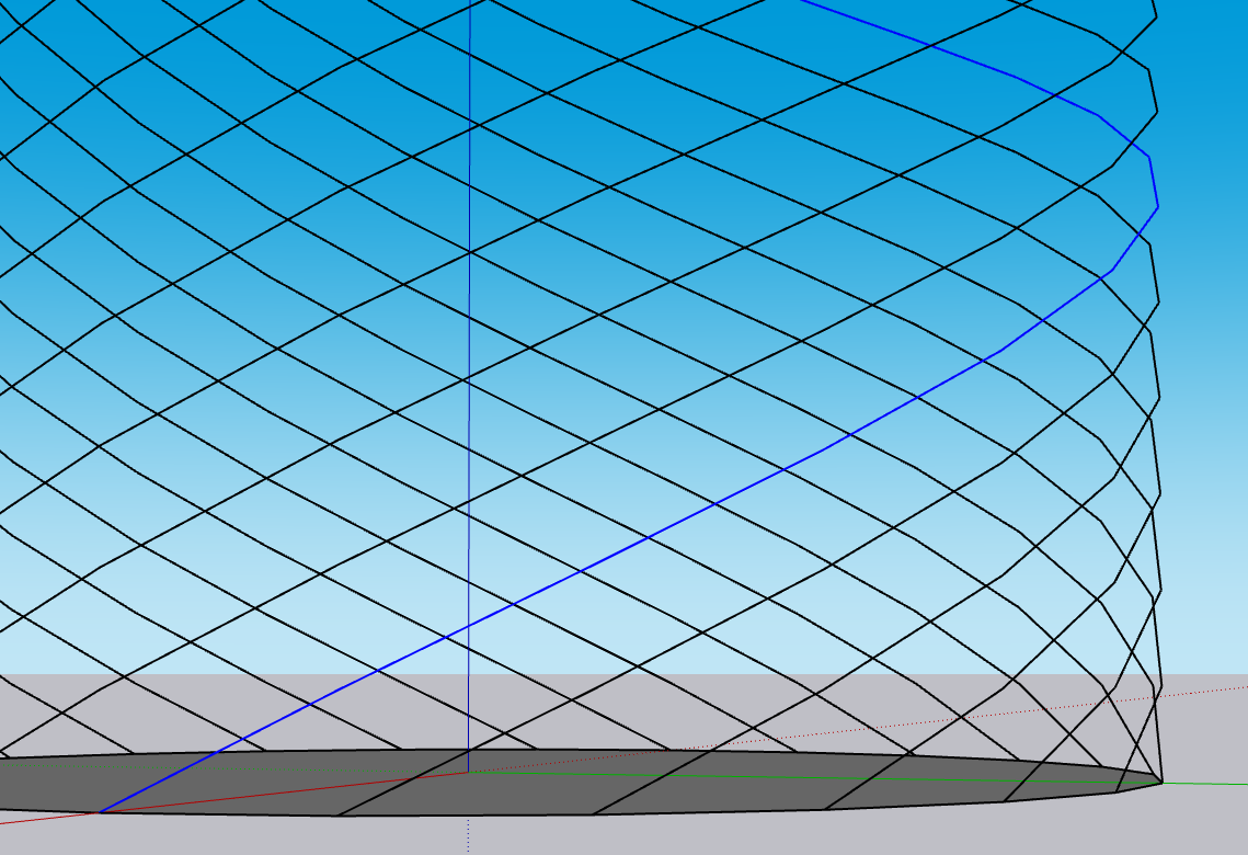

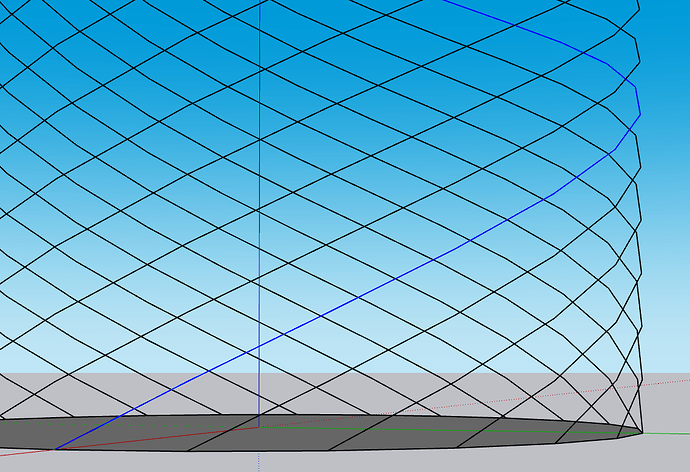

Without looking at the video or your model, if done correctly you should be able to triple click to select one helix.

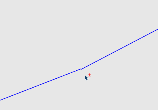

There is a gap between edge segments. It’s incredibly tiny–I had to scale the model up by a huge amount to be able to zoom in enough to see it but it’s there.
SketchUp doesn’t have a native tool to fix that. Even if it did, in this case I expect it would create more problems than it would solve.

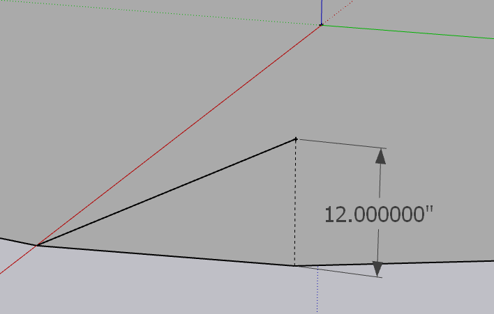

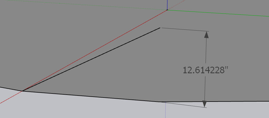

I would also suggest adjusting the height of the raised end of the edge segment to an easily confirmed distance above the circle. As it is it would be difficult to tell that you have moved the copies up exactly the right distance. Since you are modeling with Architectural units, I switched to decimal inches to show what you have.
I moved the end down to 12 in.

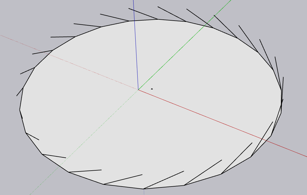

Then after the Rotate/Copy step, the Move/Copy step is straight forward enough and the edge segments can be welded.
Here’s your model with those adjustments made. You can proceed from there to make the radial array and then the linear arrays.
