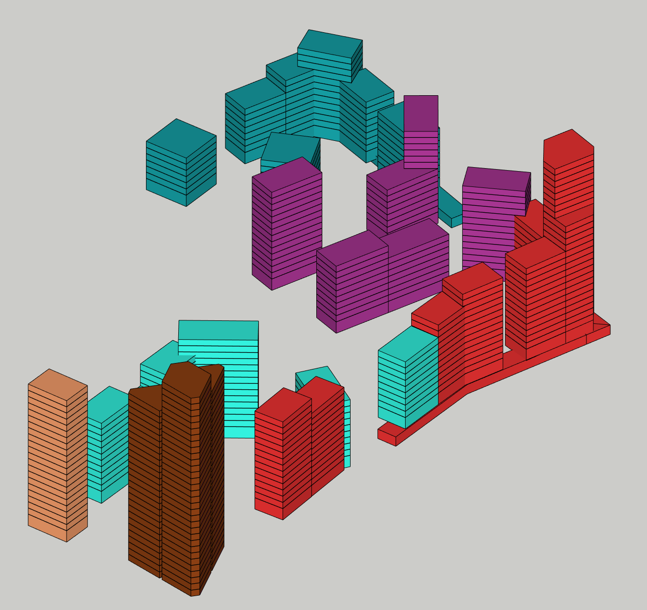

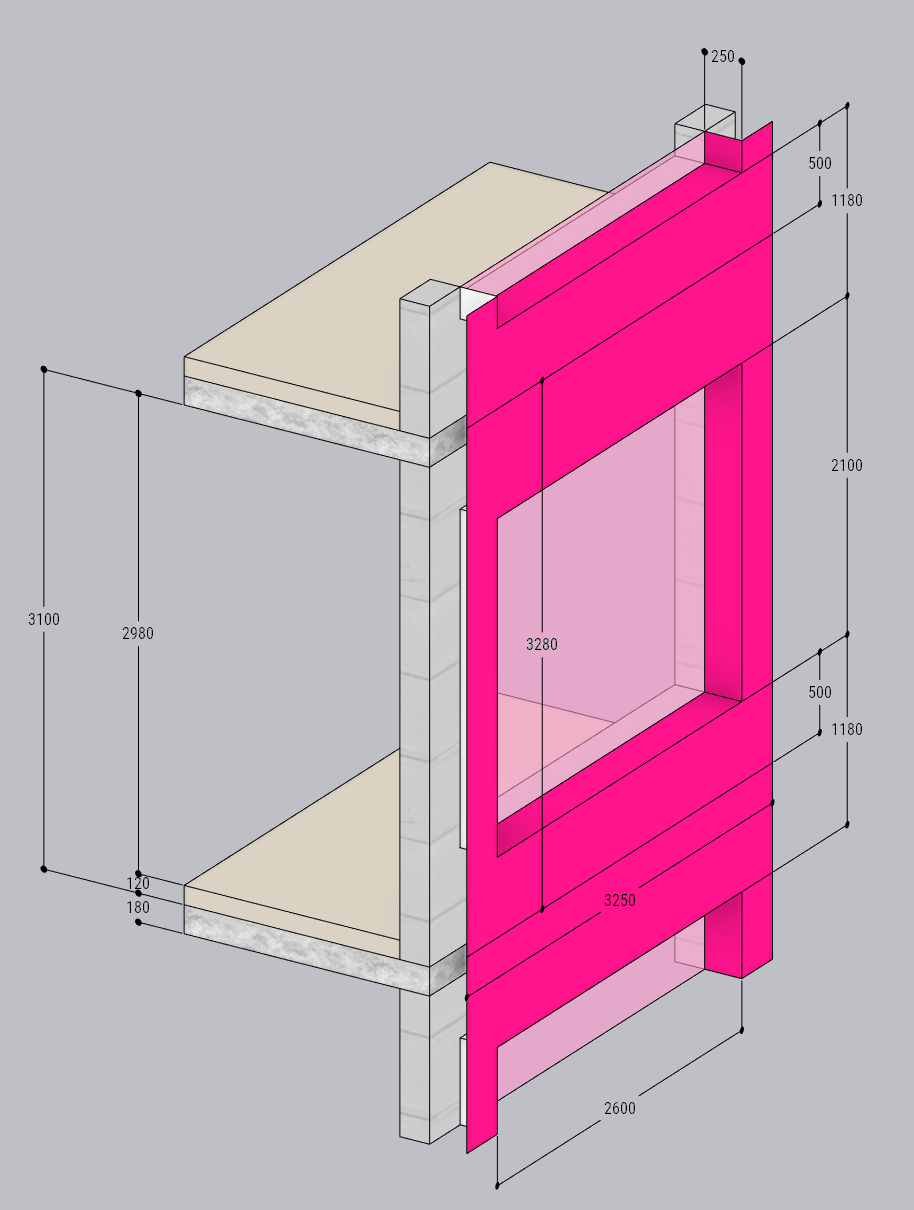

In the new graphics engine, despite the wonderful new features that have appeared since the 2024 version, the line display quality has deteriorated significantly. In the old engine, I used 16x anti-aliasing and enjoyed the perfect quality of fine lines without any dirt. In architectural work, the aesthetics of line is the most important co-factor. It is in the process of work that the importance of this becomes apparent. Especially with the advent of high-quality monitors (2K and more) combined with 16x anti-aliasing. So the maximum 8x smoothing and thicker lines in the new graphics engine have become a major step backwards in terms of the visual quality of Sketchup models. That’s the only reason I’m still using the 2023 version.
I hope that the Sketchup team will be able to restore the high quality of the lines, because it is obvious that there are no technical insurmountable obstacles to this and it looks like this problem was simply overlooked.
