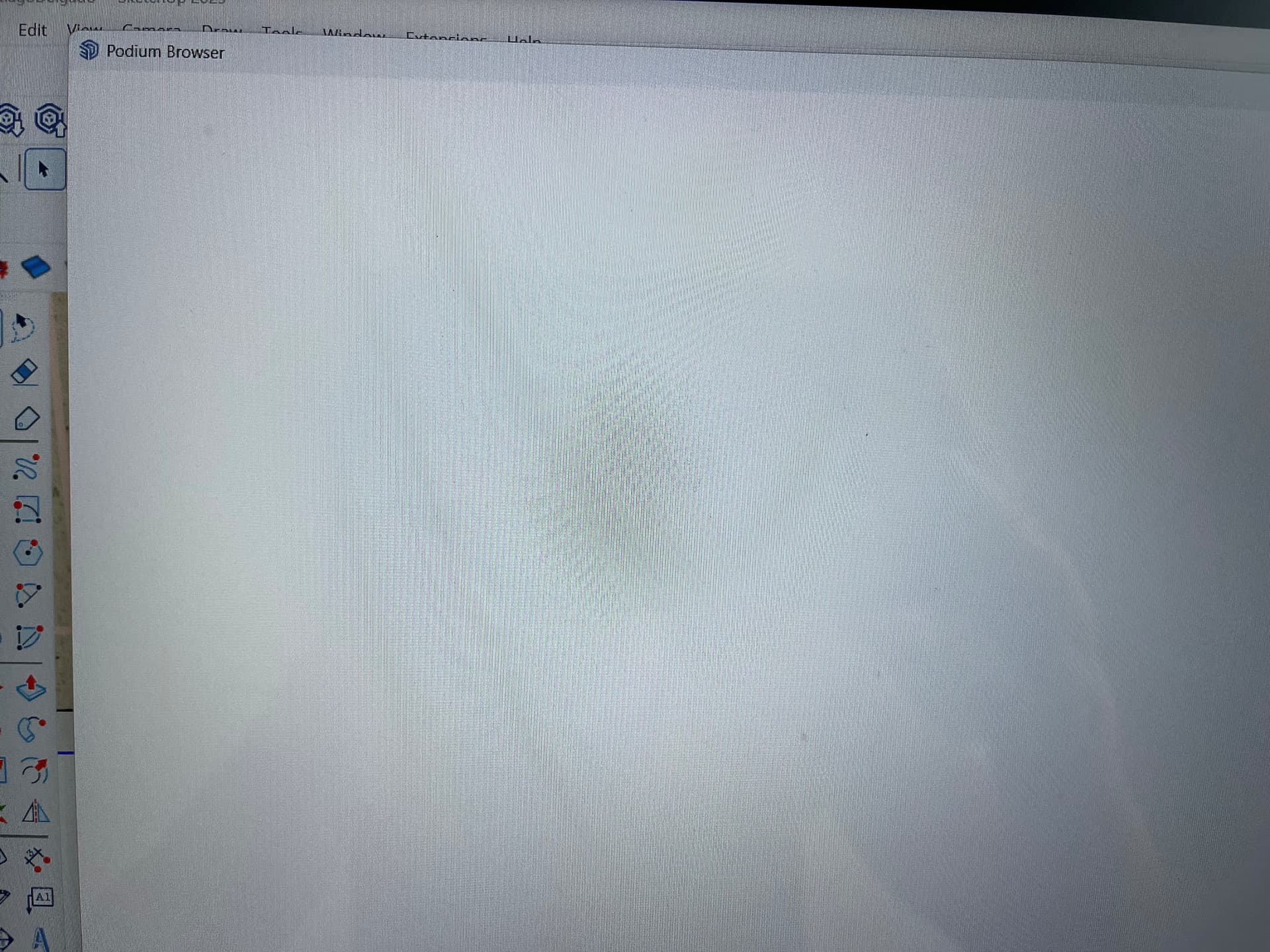

Whenever I try to open Podium Browser, the screen goes completely white and it doesn’t start. This start to happen a few days ago. Until then, it always worked fine. Attached the screen shot. <i would appreciate some help.

I’d suggest deleting the web cache folder
Close sketchup
  • on your keyboard press Windows key + R to open the “run” window
  • Paste in :
    %appdata%/SketchUp/SketchUp 2025
    press ok
There is a folder here that starts with “webcache”
Delete this whole folder.
Try SketchUp again
Thank you very much.
It’s OK now.
