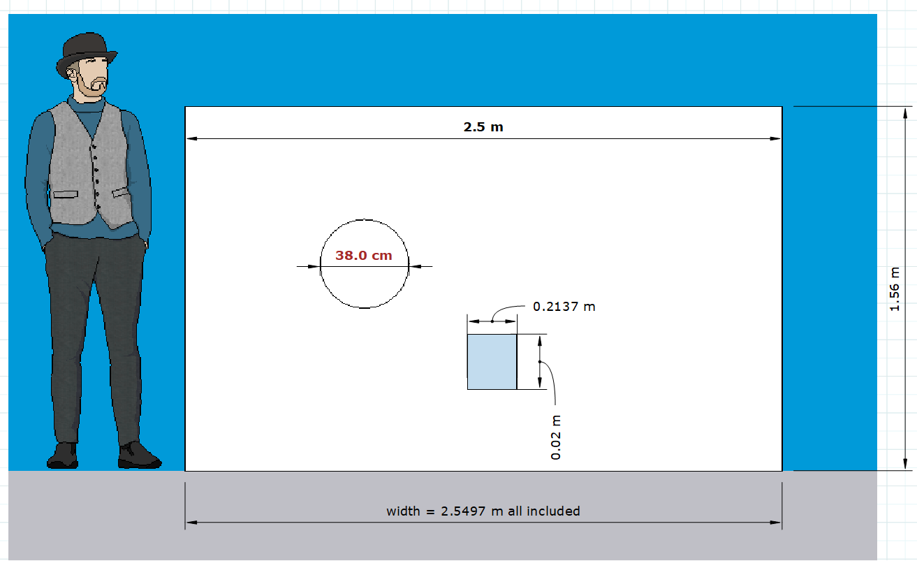

1. Select the original Layout document. This document will not be touched by the process.

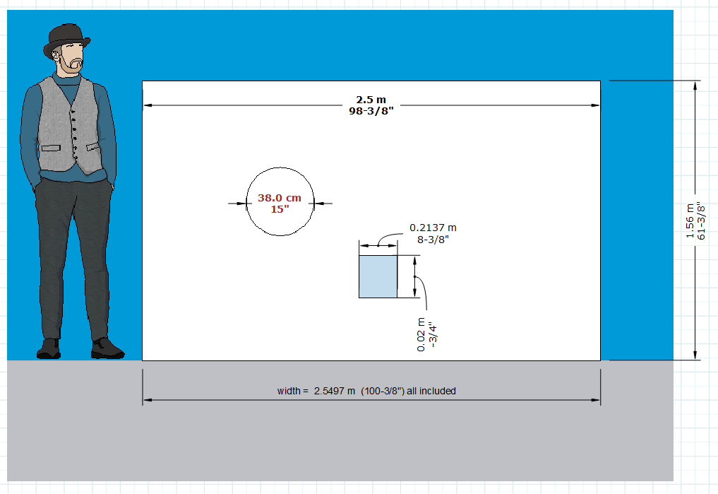

2. Choose options for specifying the path of the generated Layout document as well as the unit system for the dimensions and the type of transformation (dual units or substitution of units).
