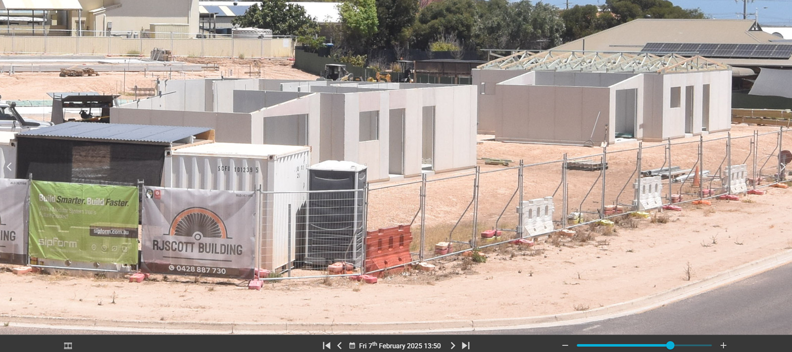

While all this was happening, the first two homes of six were underway in a South Australian low-cost housing project. Monday started, and by Friday all walls and trusses were on one. It will be interesting to see these finished with architectural attachments. These homes took around 2 days of factory fabrication and were then delivered flat-packed.
Builders we met with while there from flood-affected Lismore were blown away by the speed of delivery, installation, and final finish, suggesting this system is surely the way of the future!
