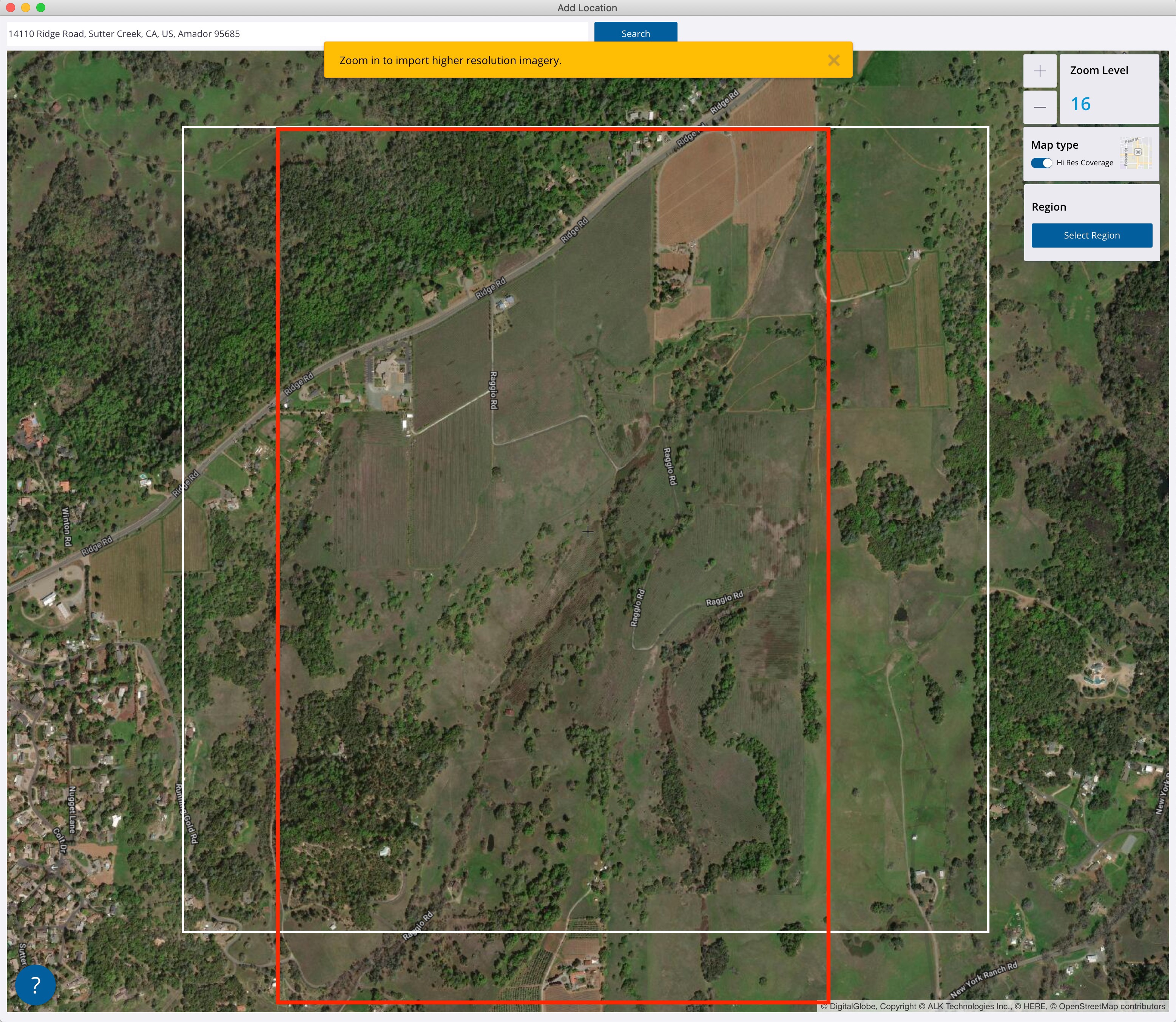

In the first image, I have outlined in red the area I would like to grab.
In the 2nd, I’m showing the hi-res zoom at 21x and it’s almost 18,000 tiles for $718. Interestingly, the hi-res zoom doesn’t change the area, just the number of tiles the area is broken up in to.
I was in the process of writing up a long reply, and as part of that wanted to test using the area you are looking at. Finding that place was an entertaining challenge! But I managed it, and now see what the issue is.
You’re trying to grab an area that is bigger than the biggest add location can do in one go. To get around that, import a large amount of digital globe, in the lower left of the area you want, then a smaller area in the upper right using Add More Imagery.
After that you could go back and get very high detailed Nearmap images, in small 200 tiles areas around the points of interest.
