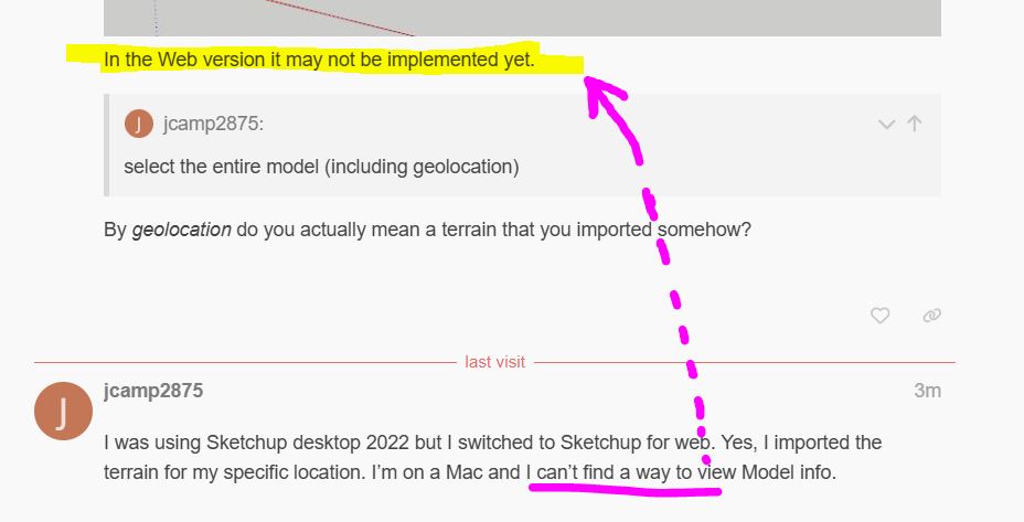

If you are still using SketchUp 2022, then you can easily see in
Window > Model Info > Statistics
In the Web version it may not be implemented yet.
By geolocation do you actually mean a terrain that you imported somehow?
I was using Sketchup desktop 2022 but I switched to Sketchup for web. Yes, I imported the terrain for my specific location. I’m on a Mac and I can’t find a way to view Model info.
