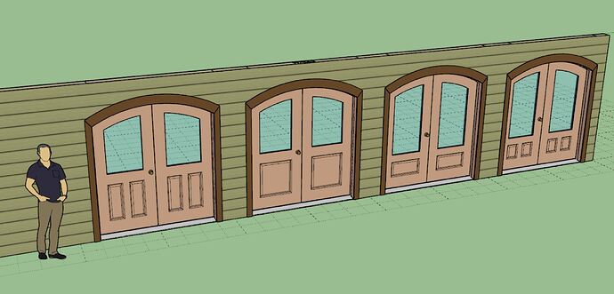

  • Added a one and two panel option for rectangular half glass and 3/4 glass doors.
  • Added a one and two panel option for rectangular double half glass and double 3/4 glass doors.
  • Added a one and two panel option for arched half glass and 3/4 glass doors.
  • Added a one and two panel option for arched double half glass and double 3/4 glass doors.
This update per customer request.
There are many other door configurations I could add but these were obvious low hanging fruit so I jumped on it and knocked it out fairly quickly. I will take another look at pocket doors and bypass doors and see if I can add some panel options to those as well.
