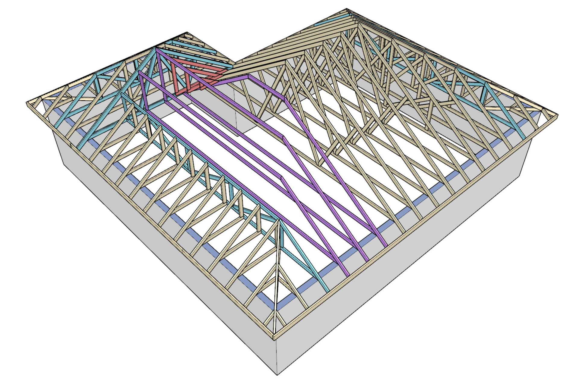

Here is another example, a much simpler L-shaped footprint with one main girder and three hip girders:
Even this roof has a suspect truss (shaded red), that I am uncertain about. Arguably this one is so simple one could truncate the smaller hip set and then run a valley set up onto the main roof (hip set). However without any overframing I think this is what you end up with. The irregular trusses are shaded in purple and have had their webbing removed.
If anyone has some truss layout plans (PDF) for complex roofs that they would not mind sharing with me that would be very much appreciated. I am specifically looking for a full set, ie. the truss layout and then the shop plans that show each truss profile. I need to study this further.
