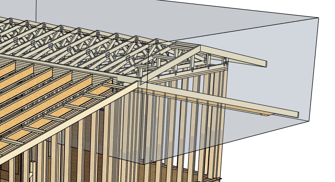

Is there a method to create a mono slope parallel cord truss with Medeek?
Yes, use the monoscissor truss.
Create a monoscissor roof then edit it, change to a raised heel (ie. 24 inches) and also set the top and bottom pitch to the same value, set your panels to 4/4, that is the largest right now.
Should look something like this:

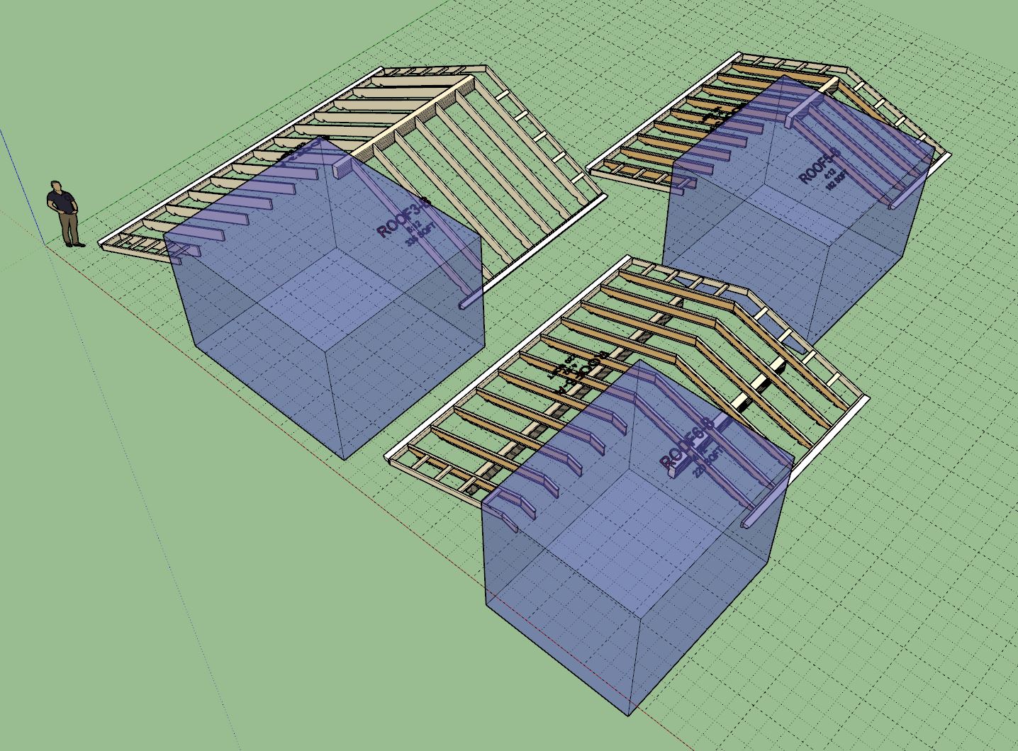

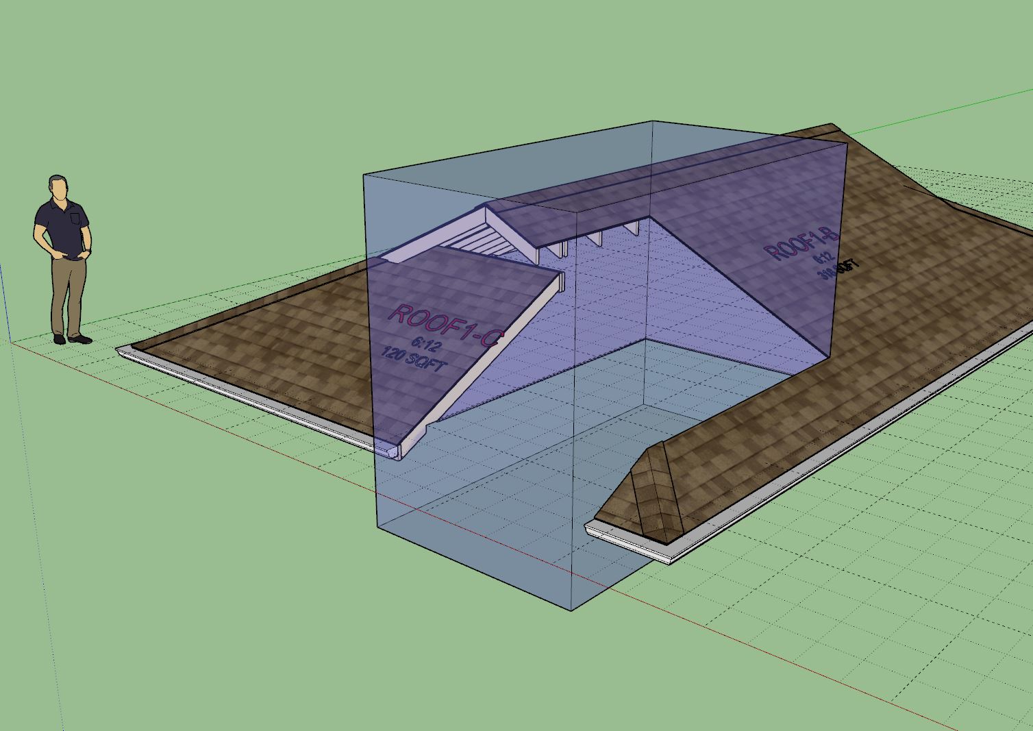

Thank you. I got most of the way there. How would you do this 2’ x 20’ bump out? Create 3 roofs, or is there an easier way?
Probably three roofs abutted together but there might be other ways to work around this one.
