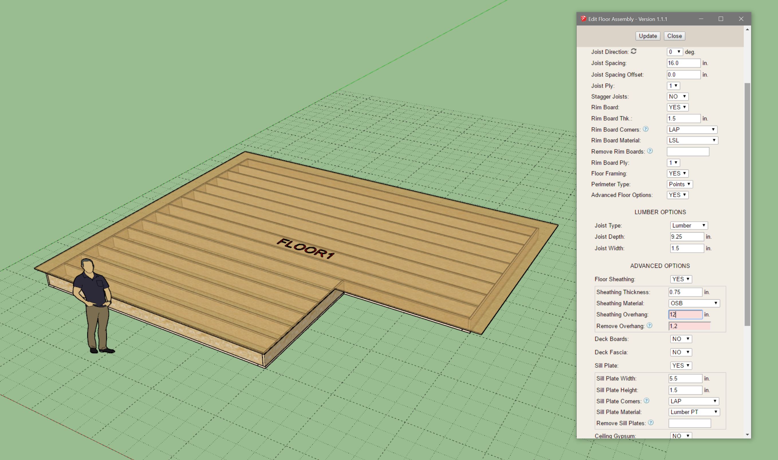

  • Enabled custom overhangs for sheathing.
  • Added a “Remove Overhang” parameter to selectively control the sheathing overhang.
Update per customer request.
This feature is identical to the overhang feature included with steel decks and will allow the user to set an overhang and then selectively assign specific edges which do not have the overhang enabled.
Tutorial #20 explains how this feature works:
