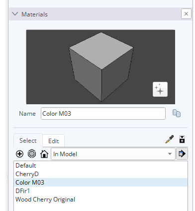

Is there search tool in the “materials” category, under the ‘In Model’ category to find a color or texture? If there are a lot of materials in the model, many which were created outside of the library or imported–adding to numerous materials, it takes a lot of time to find the material by scrolling down. “In model” is there sequence set up to find a material. thanks
There isn’t a search feature in the Materials panel. If you switch to List View you can look for them by name.

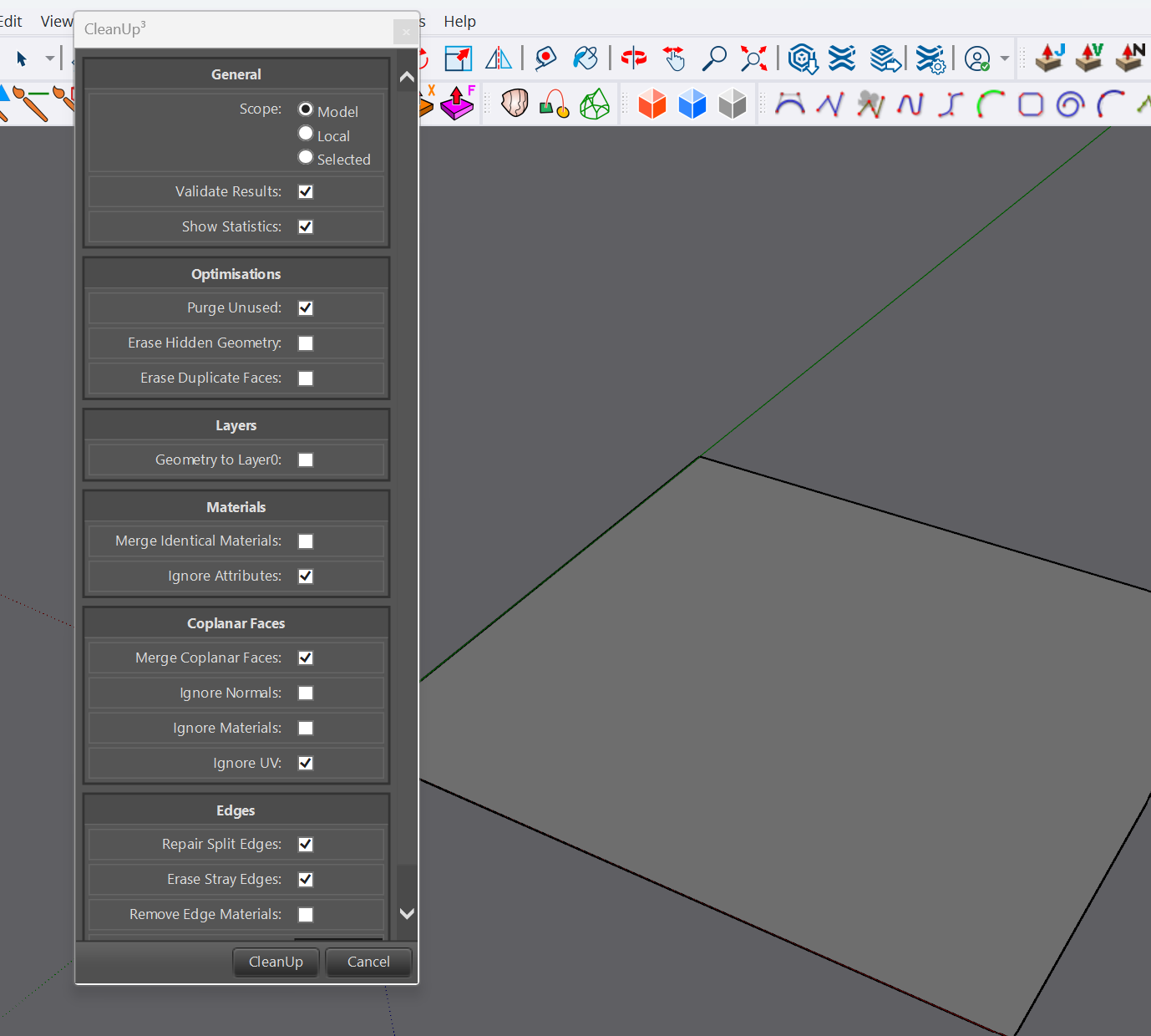

Yes, that was my other concern. Either some materials my be unecessarily repeated or unused materials for objects that were deleted. I do have an extension called “Cleanup” I think from Tomtom, which I uploaded a snapshot of one of the cleanup ext
You should go to Window>Model Info>Statistics and click Purge Unused there.

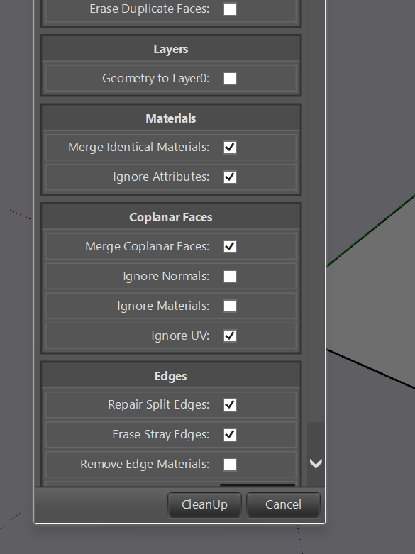

Then in CleanUp tick the box for Merge Identical Materials.
If you still have some that seem like they should be identical after that, settle on one of them and use it to replace the other(s). Then Purge again.
