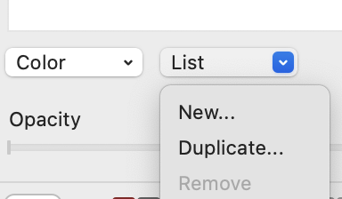

If you wanted to make your own custom set of materials, you can use the List/New feature to make the new set:
Once that is showing in Colors you can drag the small swatch squares into the new list.
