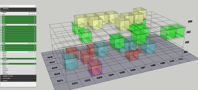

I’m an architect and SketchUp user since 2007. As the owner of an architecture studio focused on residential projects, I developed this plugin out of necessity — nothing I found on the market truly fit my workflow, and it has been in active daily use across our entire studio ever since.
If you have ever struggled with SketchUp’s native limitation where an entity can only be assigned to a single Tag, this plugin, Liserok Visibility Manager, was built for you. I am currently looking for beta testers to help polish the workflow and catch any bugs before the official release.

1. MARKERS (Independent Multi-Tagging)
  • The Problem: A SketchUp entity is restricted to a single native Tag.
  • The Solution: Liserok MARKERS remove this limitation. An object can have an unlimited number of independent Markers simultaneously, completely unconstrained by the model’s group or component hierarchy.
Within each user-defined category, you can choose between two advanced visibility matrix logic rules:
  • ANY (OR Mode): The entity is displayed if at least one of its active Markers matches the selected category criteria.
  • ALL (AND Mode): The entity is displayed only if all its active Markers match the selected category criteria simultaneously.
    (Note: Between different categories, the ALL (AND) parameter is automatically enforced).

I love how it gives live feedback on the selected object rom the drawing in the plug in menu. The marker tag shows a check on the item you select in the drawing. Very helpful.
I’m glad my plugin is working the way you want it to. I plan to gradually add that information window showing the current selection, which we discussed in our private messages. Something like Entity Info Dialog.

@mark.perrah I have added the first version of an independent Entity Info window to the plugin. You can have it turned on independently of the main plugin interface, place it wherever you want, resize it, and it primarily displays basic information about the selected element from the model. I hope it’s about as you imagined it.
We can fine-tune the visuals, skins, and similar aspects later. The same goes for the behavior of this window and what exactly will be displayed in it.
