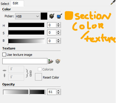

Interestingly, you can select, say, a pattern for the hatch fill but it doesn’t seem to show up.

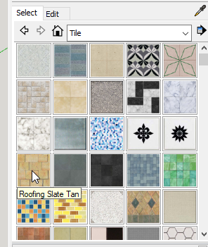

I do have names of materials when I hover over them. Maybe that is just for Mac.

And…yes, you can hover and see the material namen (as well on pc) but then each time you’ll have to search for the material.
I don’t know what you mean by a secondary fill. I can see lots of reasons for keeping textures for use in all circumstances rather than having two systems alongside one another.

That’s on Mac. Not available on the PC although it doesn’t really matter since fills currently only take colors.

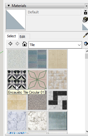

The material names show when you hover over them on the PC, too.
It might be nice to have a thumbnail and name option but I wouldn’t use it. It would take up too much space in the Materials panel. Look at the lengths of many of the material names when you hover over the. Even with the extra large thumbnails, they are longer than the thumbnails are wide.

So either the cells for the grid would have to be wider or the text would have to wrap to a new line. In either case that would just make the materials panel longer.
