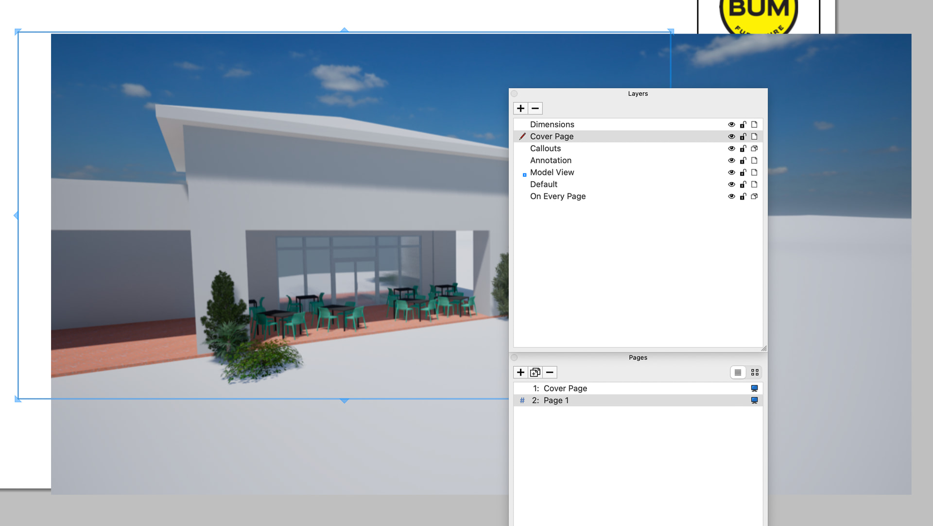

I mean that the commands are not working on the individual layers I am attempting to arrange. I click on the large image I inserted to send it behind the rectangle layer and nothing happens. Same if I click on the rectangle and hit send to front, nothing happens. This just exacerbates the issue with not being able to update image references.
So now instead of just clicking update image, I release clipping mask, delete the image I want to change, insert the new image and until today I could send the image to the back and re create the clipping mask, so it would not be in front of the text.
This is a presentation template I just want to change out the pictures and product descriptions and was working just fabulously until the latest update.

Interesting, before I import a new picture the arrange commands work.
The image is on the Cover Page layer. The tan image and the black line rectangle are on a lower layer in the stack. As I said, the Arrange commands only work if those items are on the same layer.
layers
Assuming you want to arrange the rectangle and the blue image… you have them on separate layers. No amount of moving to front or back will change where they are in relation to one another because the layer for the blue image is ‘Cover Page’ and the layer for the rectangle is model view.
In order for you to move things around in relation to one another with the commands in your first post they need to be on the same layer.
It should work with these two items… they are on the same layer - note the little blue box next to the layer name - it shows you what is selected and what layer it is on.
