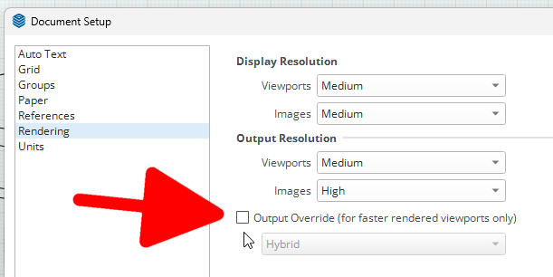

If it is ticked, the delay would be caused by LayOut rendering the raster-rendered viewports as Hybrid or Vector based on the selection in the dropdown list.

Turning off the override and using Raster it saves a few seconds on the print dialog box opening, and it took about the same time to render and write to the desktop.
