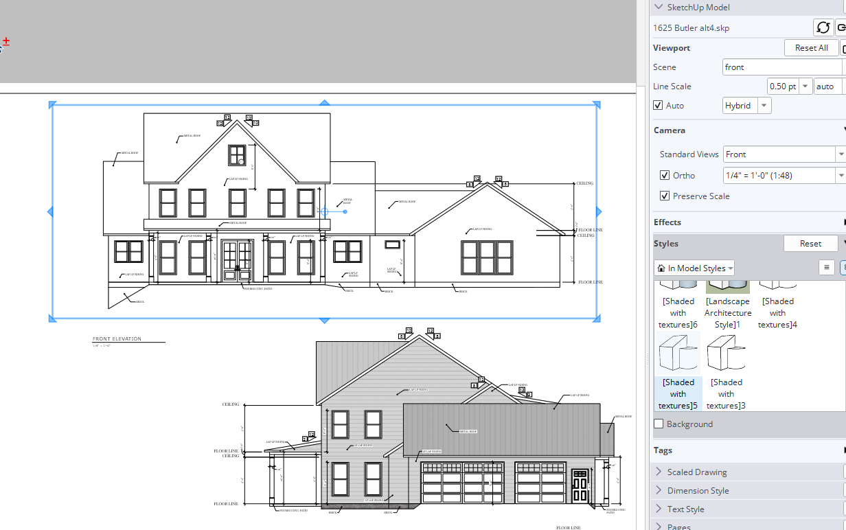

I cannot get my model to render correctly after I updated the reference model. I made a few minor adjustments and now my hybrid mode is rendering in black and white. The front elevation is black and white but the right elevation is fine. Both are referenced to the same file and with the same hybrid setting. Please help!
Share the LayOut file so we can see what you’ve got help you out.
1625 BUTLER2.layout (13.8 MB)
I have materials in all the places called out. It just quit rendering them.
1625 Butler alt4.skp (3.6 MB)
My error. I see that you’ve overridden the style for the front elevation and that viewport is using a Hidden Line style (despite its name).

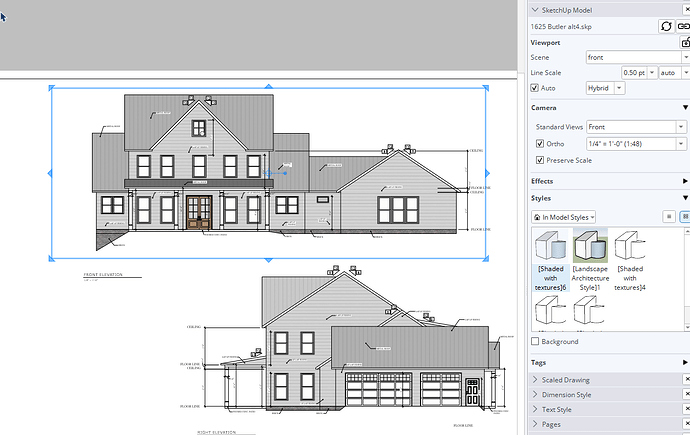

After resetting the style:
