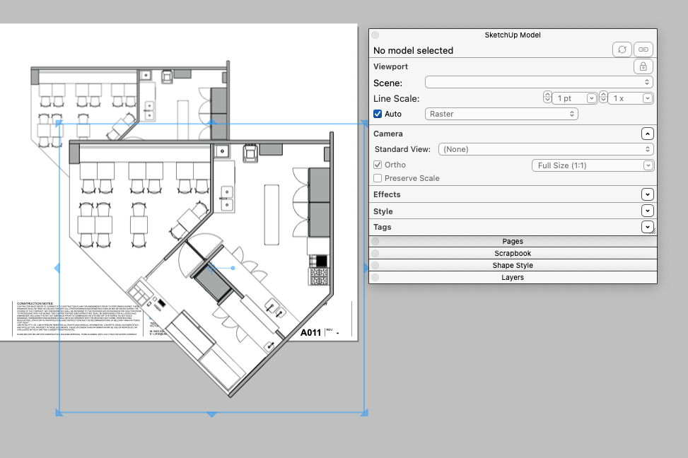

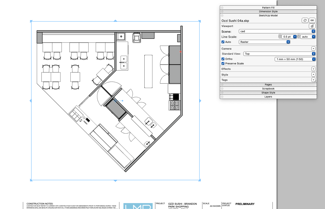

I have my sketchup model inserted into Layout, when I copy and pasted the layout it paste in but the size is then bigger and it losses reference as can be seen in the "Sketchup Model dialogue box …it is not linked anymore…
the attached images show the before pasting and after…the after shows that it has lost reference .
