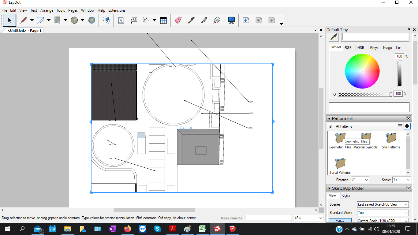

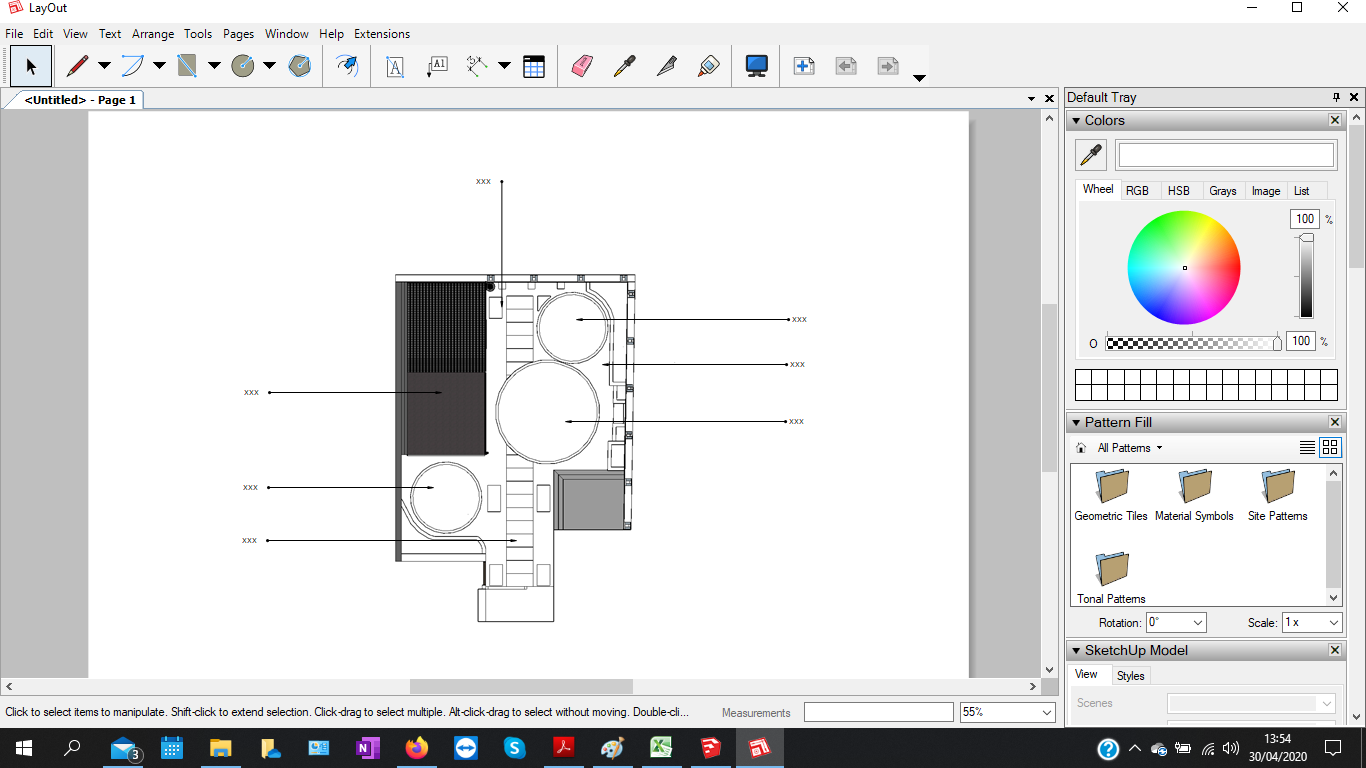

2020-04-30 (2) Thanks for your reply, Dave. See attached examples. To show the problem, I re-exported my sk file to layout, put some labels on, then re-opened Sketchup (from layout), drew in a couple of extra boxes, saved it, and then check out the result…
Your first screen shot shows exactly what I suspected. You haven’t created a scene in SketchUp to use for the viewport in LayOut. Notice the SketchUp Model panel shows the Scene as “Last saved SketchUp view”. When you went back to SketchUp you moved the camera while editing. (Zoom, Pan, etc.) That change was saved and is reflected in the viewport. The correct procedure is to create a scene in SketchUp that shows the model as you want to display it in LayOut and then select that scene for the viewport. That gives you a fixed point of view for the viewport even if you save the model with a different camera position later.
