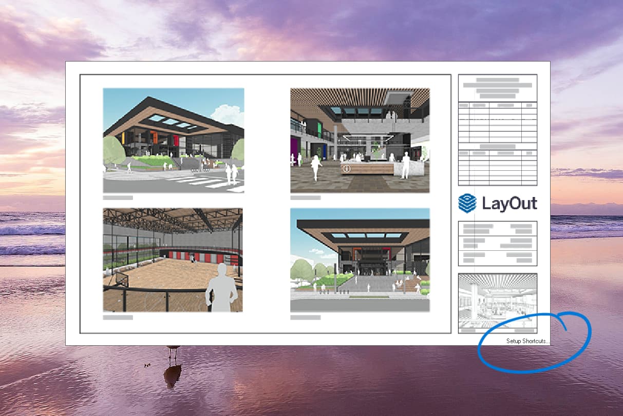

Layout 2025 start up freezes when it gets to 'Setup Shortcuts...'
Consistently having issues with Layout 2025 pro not booting up. It gets to the point in the start up box where it says ‘Setup Shortcuts…’ and it just stops.
Sometimes it will open normally, if not a bit on the slow side. Sometime it’ll open if it just sits there for 30 min or so. Lots of times, like right now, it just won’t open at all.
