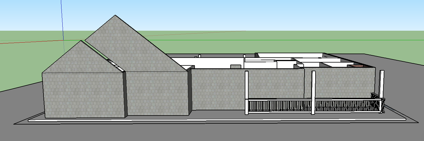

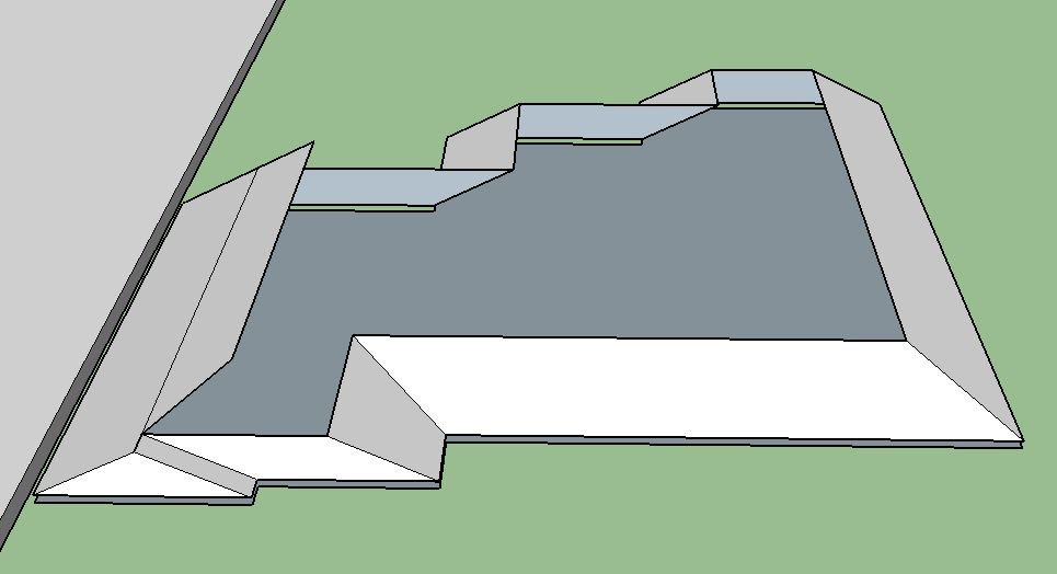

I bought the one year Instant roof, and i cant seem to make the kind of roof i want to.
Thats the look i want to get, that i drew myself but now im missing the resort of the roof can anyone help me ??

It looks like its having trouble connecting the hip roof with the tall gable.
Would a SketchUp “native” solution be of any help to you? It doesn’t look that complex to do.
Yes i could draw it myself but it annoys me that i bought the plugin to save time just to end up doing it myself again…
