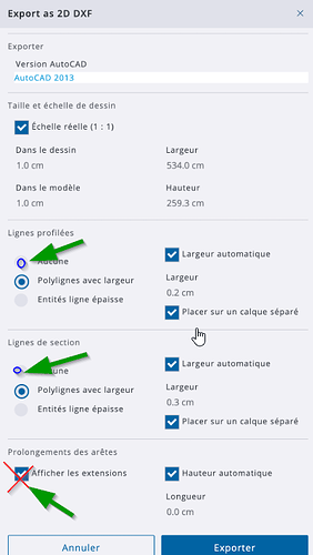

SCheisse, its even worst :frowning:
Try with this:
If @dezmo last settings suggestion do not help please share the SKP file and share the DXF file so we can see how you have it setup.
