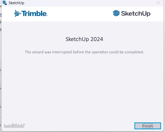

Installation Issues {Wizard was interrupted} SOS!
PLEASE help i seem to be stuck on this
The screenshot doesn’t really tell us what is actually happening. My guess is that your computer is blocking the installer from downloading its missing pieces from the Trimble and Microsoft sites.
